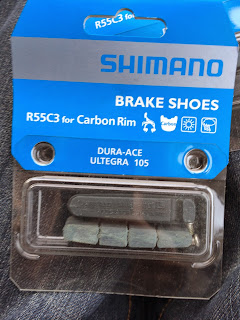

johnnyboydotca wrote:
eric wrote:
johnnyboydotca wrote:No, they have a version for carbon brake tracks as well. They are the blue ones not the black ones for alloy rims.
The carbon pads are the R55C4, not the C3. The pics I found show black pads.
I thought the same as well. But I actually have a couple of sets here. I had ordered these originally for my old Dura Ace C50 clinchers and then found out they were for carbon rims only when I got them. I think I will try them out on the new wheels at least to see how they compare tot he stock blue pads that came with the wheels.
Finally a decent day to try out the new wheels from Yoeleo. I found the Shimano pads had more bite and modulation than the Chinese blue pads.
