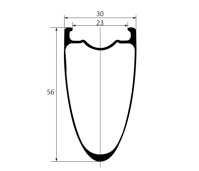

I was planning to get a pair of Light Bicycle 46mm deep rims but now I'm wondering if I should get their new 56mm deep ones. I'll be using 25mm 4000sII tires, will they be too wide for the 56mm rims in the front? Would I be better off with the 46mm in the front and 56mm in the back?
Yep, the 30mm wide wheel will be better.
On the 46mm rims (28mm outer, 22mm inner) the GP4000II in 25mm will measure about 29.5mm wide, At high yew angles the wind will catch the side of the tyre.
On the 56mm rims (30mm outer, 23mm inner) the GP4000II in 25mm will measure about 30mm wide and be a better aero match for the wheel.
For ideal aero, you want the front wheel width to be 105% of the tyre width.
On the 46mm rims (28mm outer, 22mm inner) a GP4000II in 23mm will measure about 27.5mm wide,
On the 56mm rims (30mm outer, 23mm inner) a GP4000II in 23mm will measure about 28mm wide

Bontrager just got back to V-shape and those wheels are among the fastest around:
But don't expect to feel any speed difference of wheels with the same height but different shapes - it's all within a few watts. ;)
They only noticable difference is crosswind stability, and despite all the Zipp marketing round shapes are worse here and teardrop shapes as seen on Reynolds rims best.

Not my experience. Rims with a narrow leading edge blow around in crosswinds far more than the more rounded profile wheels.
Suggest you read this;
http://flocycling.blogspot.com/2014/09/ ... l.html?m=1

How old and wide were the V-shape rims you used? You can't compare an old set with strongly overlapping tires to the new ones.
warthog101
Posts: 2
Joined: Wed Sep 25, 2013 10:05 am
by warthog101
Read the link.
It is about the aerodynamics of the front of the wheel and the back of the wheel matching or approximating each other at yaw angles so that the force applied front and back is similar, ie less steering force applied.
I fail to see how a V shaped rim can have the same trailing profile as the tyre.
:noidea: According to the XXX whitepaper Bontrager aimed to reduce sideforces and ended up with a "sharper" shape. Tour mag. and many users claim the Reynolds are affected least by crosswinds. So...
