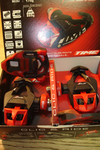

Pedals came from STARBIKE

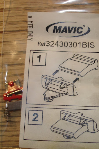

and some new pawls for the mavic freehub.
