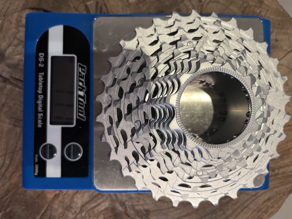

Weight of the bike is now 6,70 killogrammes. Next saving will be to replace the Dura Ace 11-30 cassette with a ZTTO 11-30. That would probably save another 90 grammes. Then, hopefully a zero offset Alpitude seatpost and...
