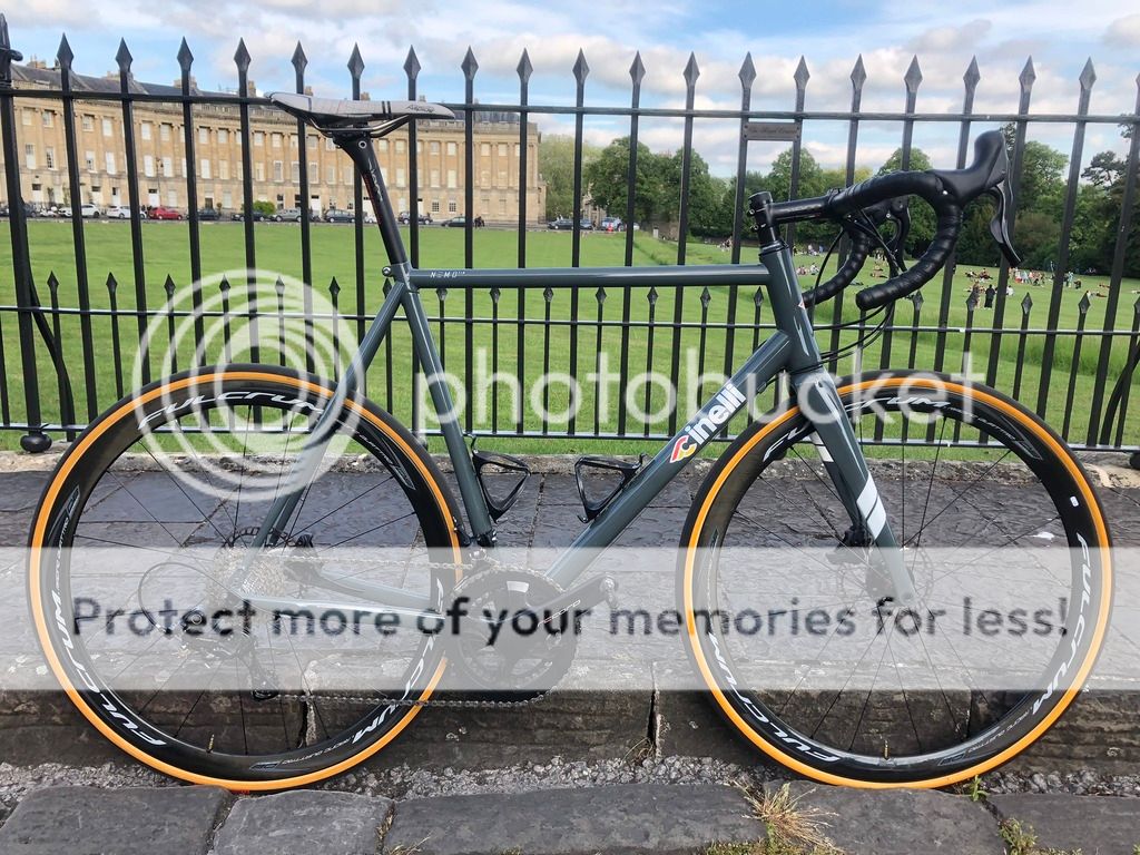

Update: Wheely happy with the tyre choice.. the frame should be arriving within the next few hours!
welchy
Posts: 279
Joined: Wed Jul 01, 2015 4:04 pm
by welchy

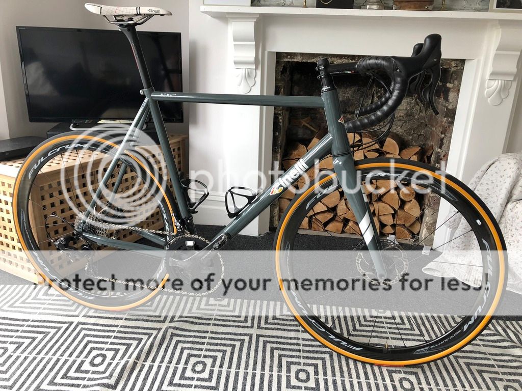

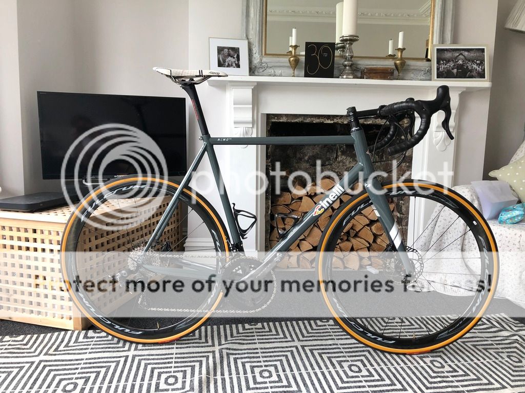

She’s arrived... gotta get it built, build photos to come!

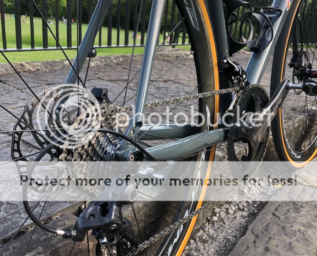

Roel W
Posts: 741
by Roel W
What rotors are that? These have 6-bolt connection and Fulcrum wheels do have center lock so you had to use an adapter?
And why not Campa rotors that come with the groupset?
CANYON Ultimate AL 2010
CANYON Ultimate CF SL 2014
CANYON Ultimate CF SL disc 2018
Instagram @roeleur
welchy
Posts: 279
by welchy
Roel W wrote:
Sat May 18, 2019 8:00 pm
So the fulcrum wheels I bought came as standard with 6 bolt disc setup, unfortunately AFS/Spline centrelock wasnt an option as I bought them on eBay.
Therefore the only option is to go for a matching Magura disc to go with the Campy MT8 style Caliper. This leaves the same thickness disc.. so the discs are Magura HC SL rotors (if I remember correctly). This means the setup should be the same as the AFS rotors.
