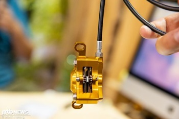

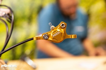

Trickstuff Piccola C22
News is also available at the Piccola brake. The lightweight caliper gets a thorough update missed. By a slightly modified design, a higher rigidity could be achieved. Also the cable outlet has been changed: This now runs straight and leaves the saddle on the inside. Despite the changes, the same brake pads can still be used. Also at the dealer there is a small change: From now on the Piccola will only be sold with carbon levers. This allowed you to maintain the low weight despite the slightly heavier saddle. Who wants to call the good piece his own must shell out a price of 450 € per brake.
Stiffer caliper and modified cable outlet
Available with postmount and flatmount standard
Price 450 € (per brake)
