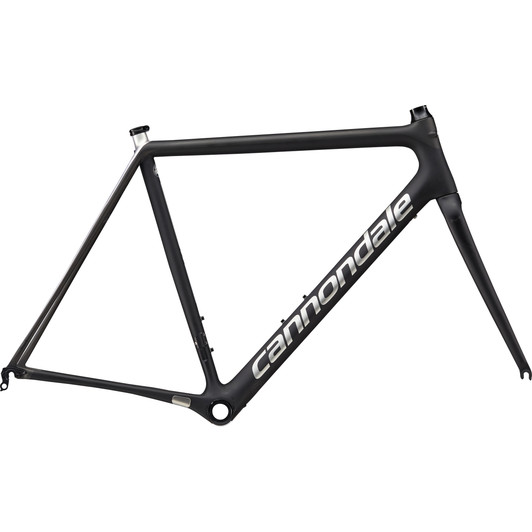

Well it's finally arrived. After cracking my BMC (my cross bike got knocked off the hook holding it up and it crashed down cracking the top tube on my BMC underneath it :doh: ) a replacement 48cm HI Mod frame has finally arrived to replace it.
This is the version I saw in the box at my LBS this morning
I thought it was a matt finish frame with silver paint on the stays and fork, but no, it's a shimmery metallic fade on the top tube and frame with silver on the stays, inside fork legs etc. SO it will be heavier than I thought, but it looks HOT AF!! I was hoping for a sub 5 build but now as it's a painted frame I'm hoping for sub 5.5
Anyway, I'll update with parts list when I get home and spreadsheet and might ask for some advice as I can't decide on the Extralite stem or the MCFK stem
