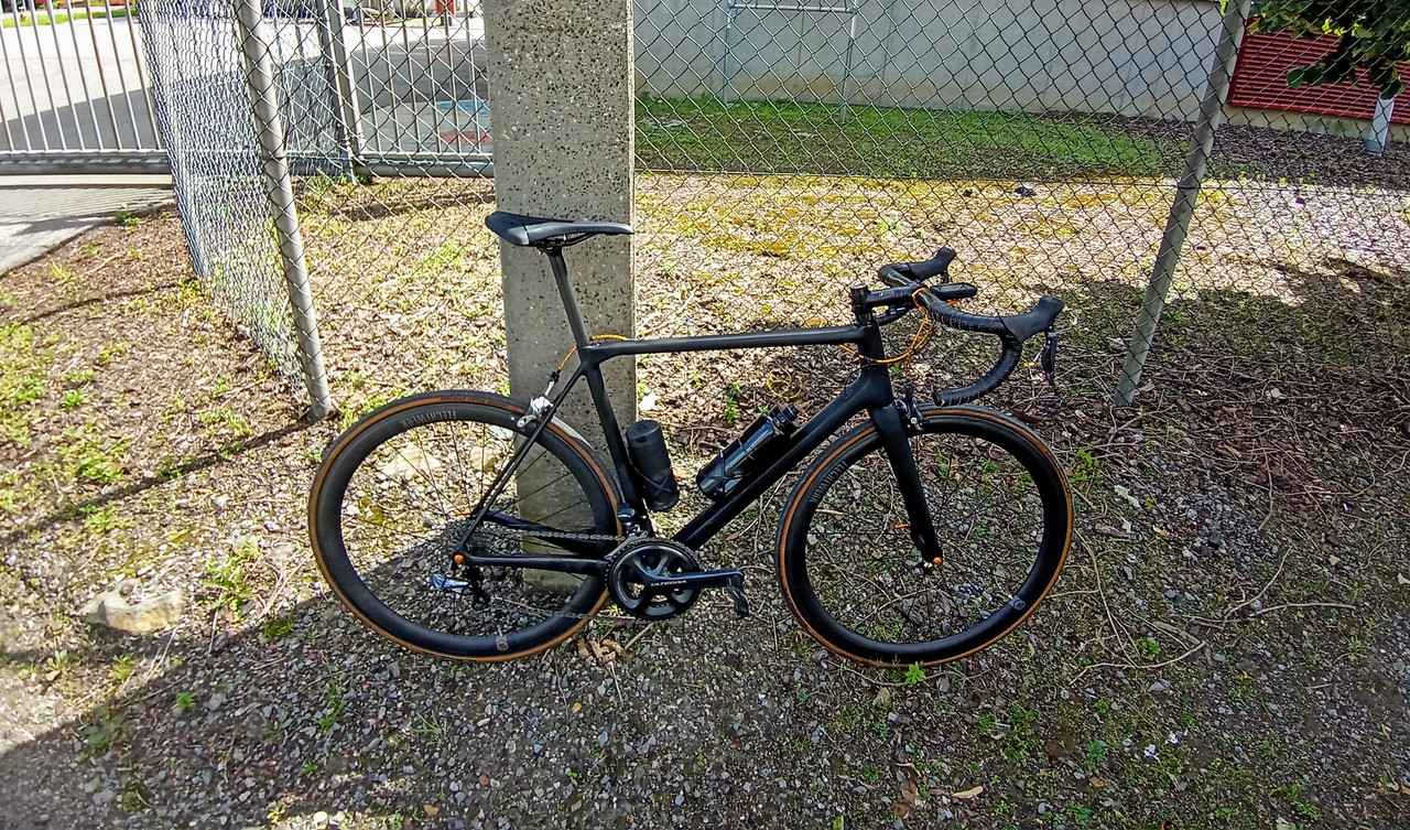

4 years and still happy. Thought ima share some impressions and update.
What changed since then:
- Grand Prix 5000
- 4iiii left side power meter
- new chain
- new Dura Ace bb
- Hylix Carbon Seatpost
- (serviced cockpit)
Sitting at just under 7kg now
- Grand Prix 5000
- new chain
- new Dura Ace bb

Hey Kidrob, great build.
I'm looking into getting one of these to use an old sram force groupset i have lying around (seems like rim brake frame options are very limited these days). My main concern is the tyre clearance (i note the nominal limit for 25mm tyres).
What has your experience been with tyre clearance?
Specifically:
1. Have you had problems with taking wheels in and out of the frame - i think somebody else on WW commented they had to deflate their 25mm tyre each time
2. Do you think you would run into issues with a wheel with wider rim depth and thus wider tyre inflation? I guess what I'm asking is, where is the clearance the tightest (i.e. in between the chain stays/fork at the tyre or laterally at the rim?)
Thanks!
Specifically:
Thanks!
My wheels are 26mm wide, and I run 25mm Grand Prix 5000. With this being said, it is indeed insanely tight and I really dont think I could go any wider. The problem are the rear chainstays. No problem to take in or out.NovellaNovelli wrote: ↑Mon Sep 27, 2021 5:07 amSpecifically:
