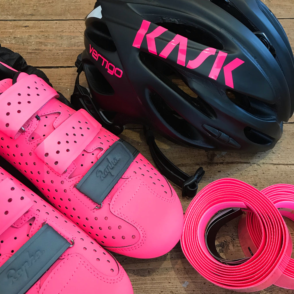

If anything it's had the opposite effect, I'm maybe imagining it but I seem to get slightly more room and have had less friction with drivers. I did the tape to match my Rapha climbing shoes, in pink and new graphics I put on my Kask lid. I have wondered if some drivers initially assume I'm female and are less aggresive towards me?
Quick shout out to the guy at Cyclestick too. He supplied the graphics for my lid to match the Rapha pink perfectly. The pic on his website is my photo.

Pink bar tape absolutely rocks. Pinker the better, perfect match to the shoes, maybe pink socks are OTT but its hard to go OTT on pink.
