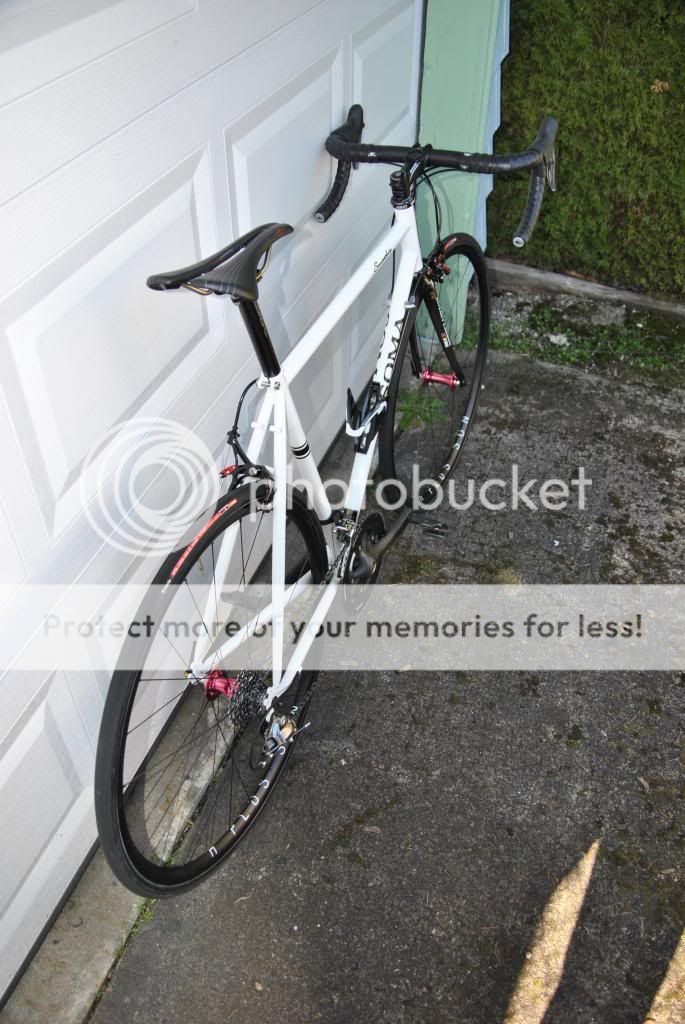

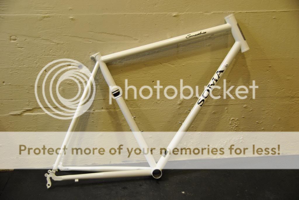

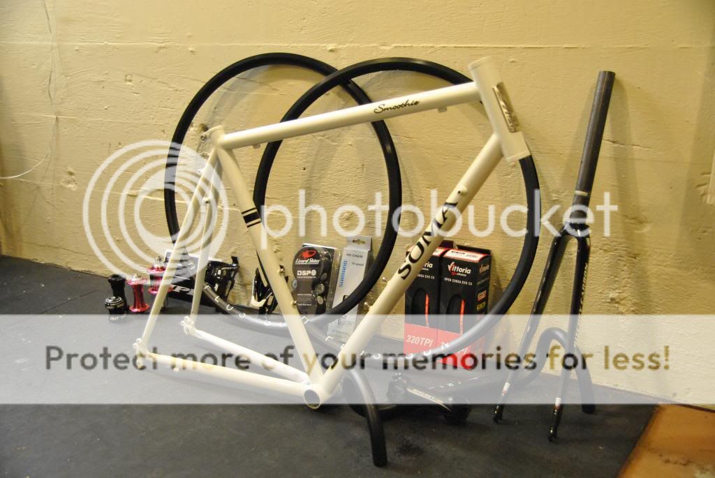

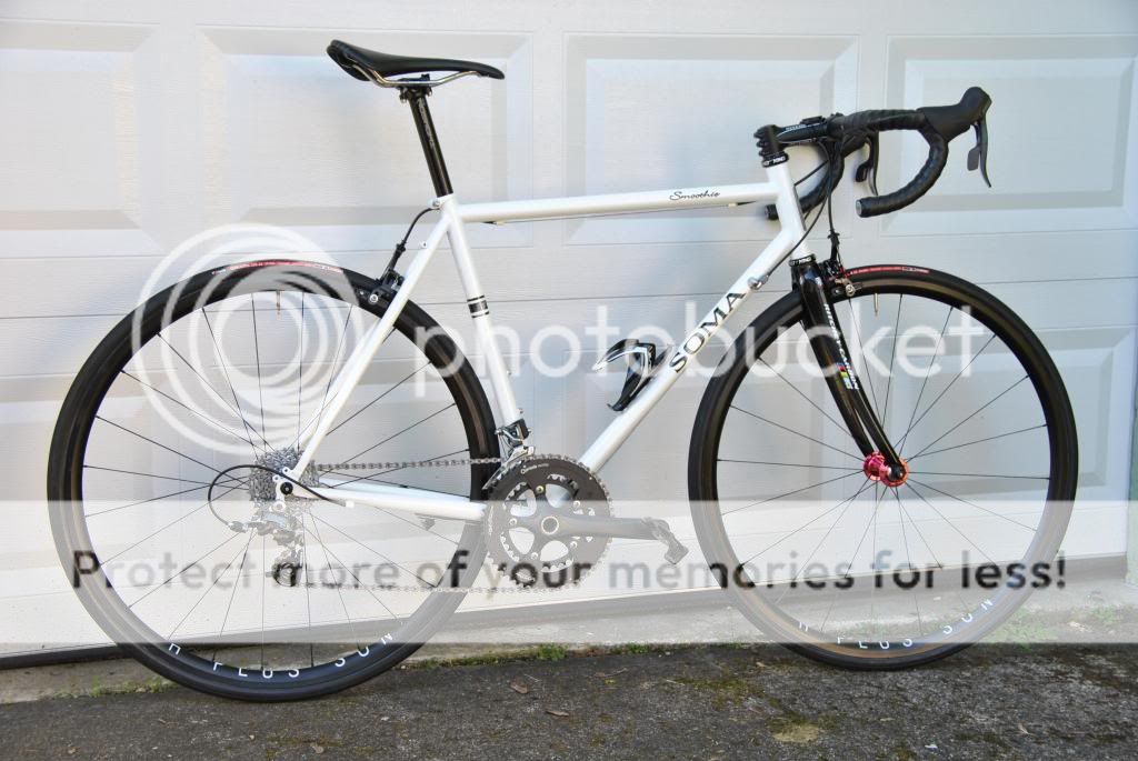

It took awhile but here she is:
(size 56)
uncut
42 cm
110mm

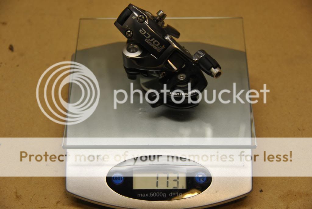

Stripped 172.5 110mm Force
Hope to get a total weight this week!
Cheers

Nice! How does it ride?

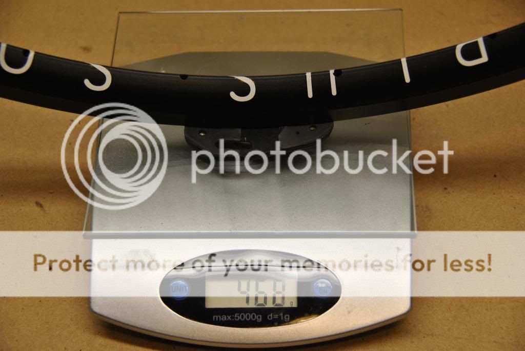

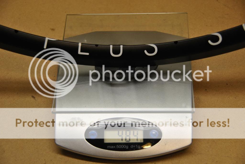

I'm guessing the Archetype weight is for the rear rim? My 24 hole came in at 482 so looks like the weights are pretty consistent. After the ano started wearing away on my brake track (after the first ride) I was practically over using my brakes to get it all off. Doesn't take too long though :)

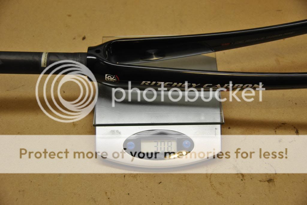

I like this built a lot! Wouldn't consider this as a rain bike tho with CK hub, RED and Praxis.. The Ritchey fork is very light! I thought only AX and Enve make forks with that weight. Where can one buy the fork online, if I might ask?

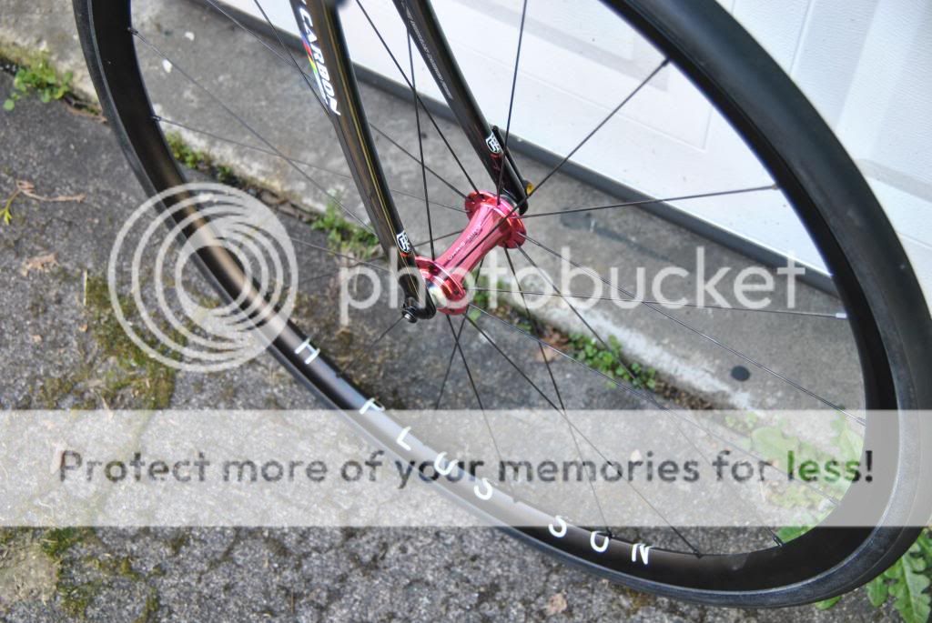

I like the overall looks of this bike, just wonder how long the wheels will look nice when used as a rain bike. That anodized finish will soon wear off. Wouldn't a silver brake surface have been a better option?

gravity wrote:I like this built a lot! Wouldn't consider this as a rain bike tho with CK hub, RED and Praxis.. The Ritchey fork is very light! I thought only AX and Enve make forks with that weight. Where can one buy the fork online, if I might ask?
Not to threadcrap, but I saw this build and I have a Ritchey fork as well which is a rarity these days as most builds seem to feature Enve.
I got the Ritchey Carbon Pro for ~ $200 a couple of years ago at Bicycle Outfitters Indy to replace my stock Allez alloy/carbon boat anchor fork. The pro only weighs 25g more than the WCS according to Ritchey's website, 345g vs 325 (steerer uncut). Sadly I did not have scale at the time to confirm. Looks like they have the Pro for 220 right now and the WCS version for 270/300 depending on the rake you need. They also have a 15% coupon code for your first order. Just google them. Keep in mind these are avaiable in straight 1 1/8".

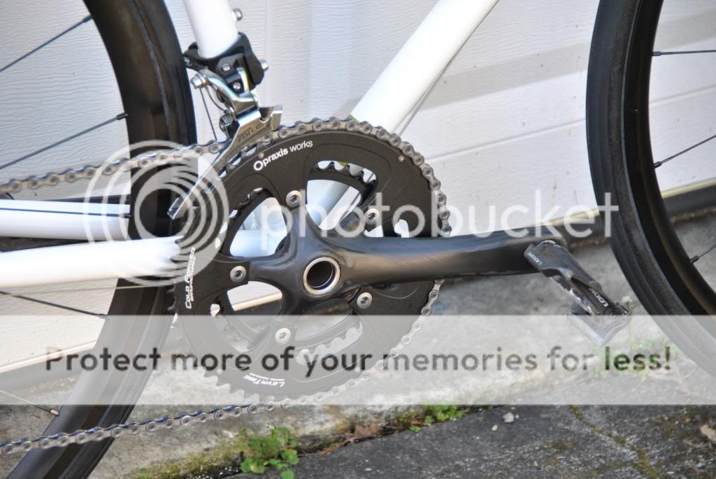

Imaking20,

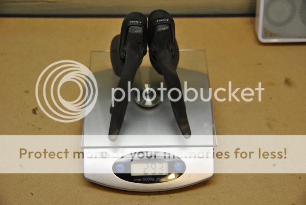

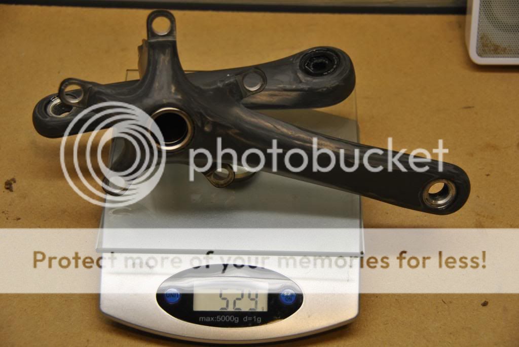

I am considering picking up some force levers as i transition from shimano to sram. I already have a red crank and force brakes. How did you got about de-labeling the levers and cranks? Did you just use fine sandpaper, then finish with a new clear coat? I'd love any advice.

@Ssalmon - this is my first steel frame. The ride is nice. Quite a bit more stack than I'm used to - not sure if I'll leave it that way considering it will likely see longer distance (and be ridden with more clothing) or get a -17 stem. I don't have a lot of time on it yet so I can't give too much feedback. Will update when I do though!
@fio - the rear rim weighed 468, front 482. A little porky but oh well.

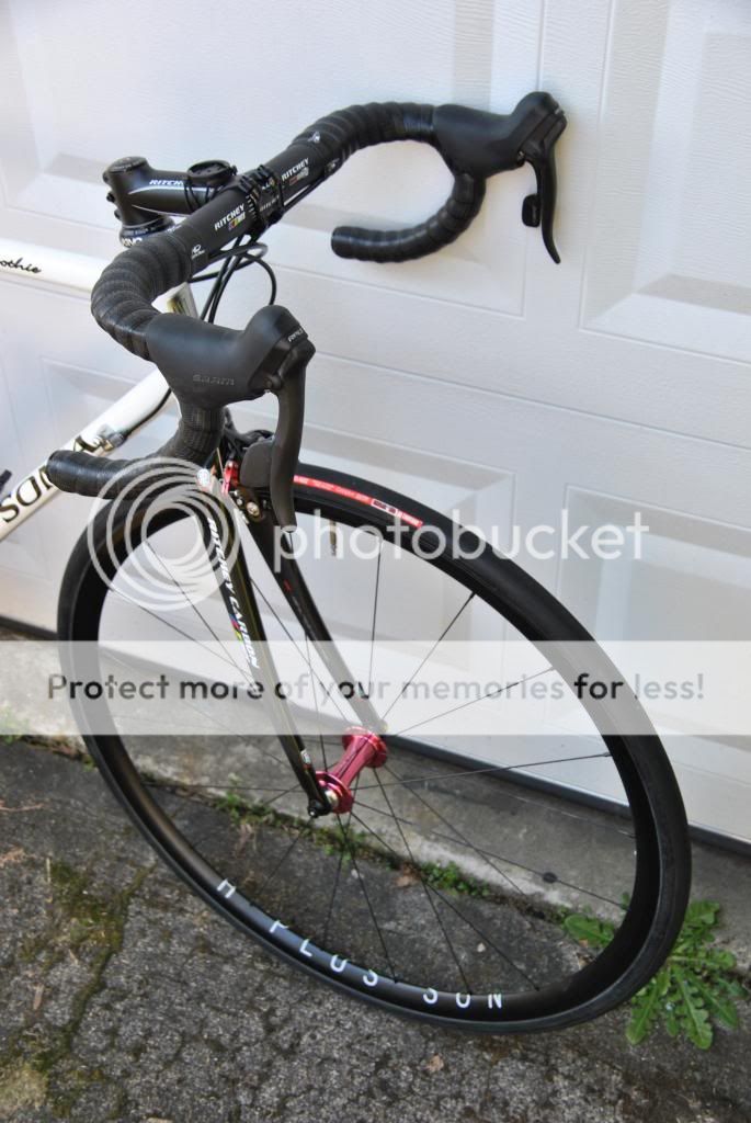

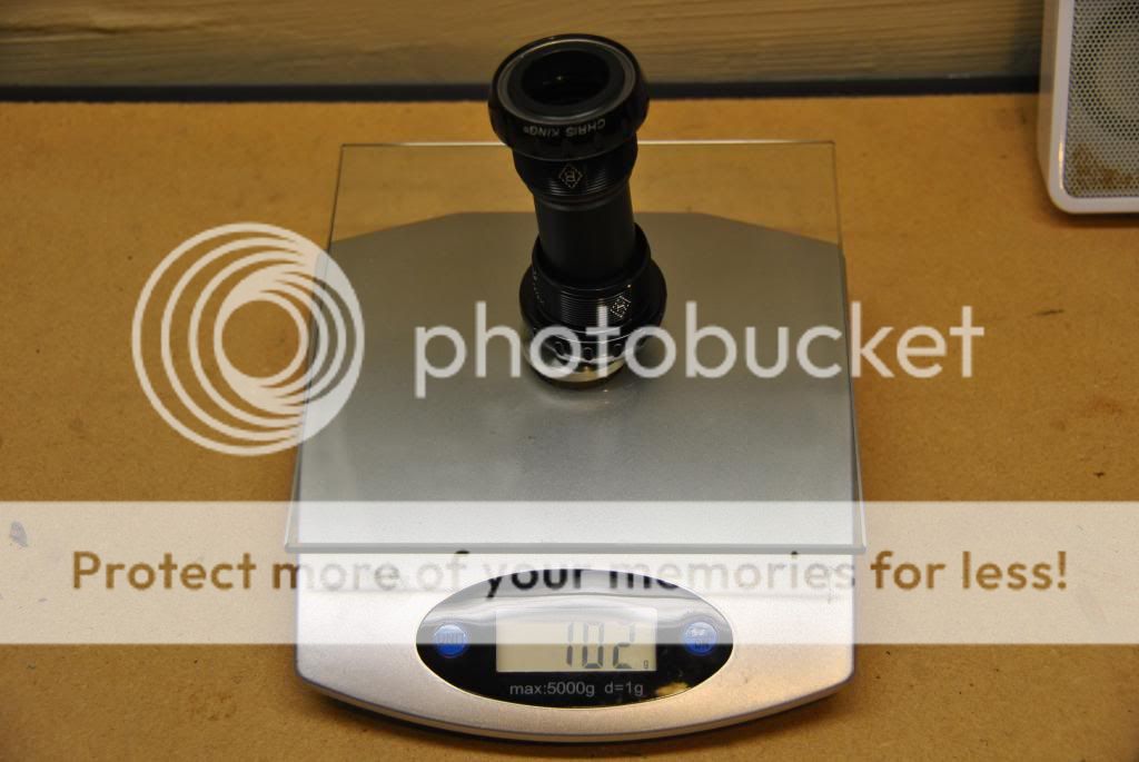

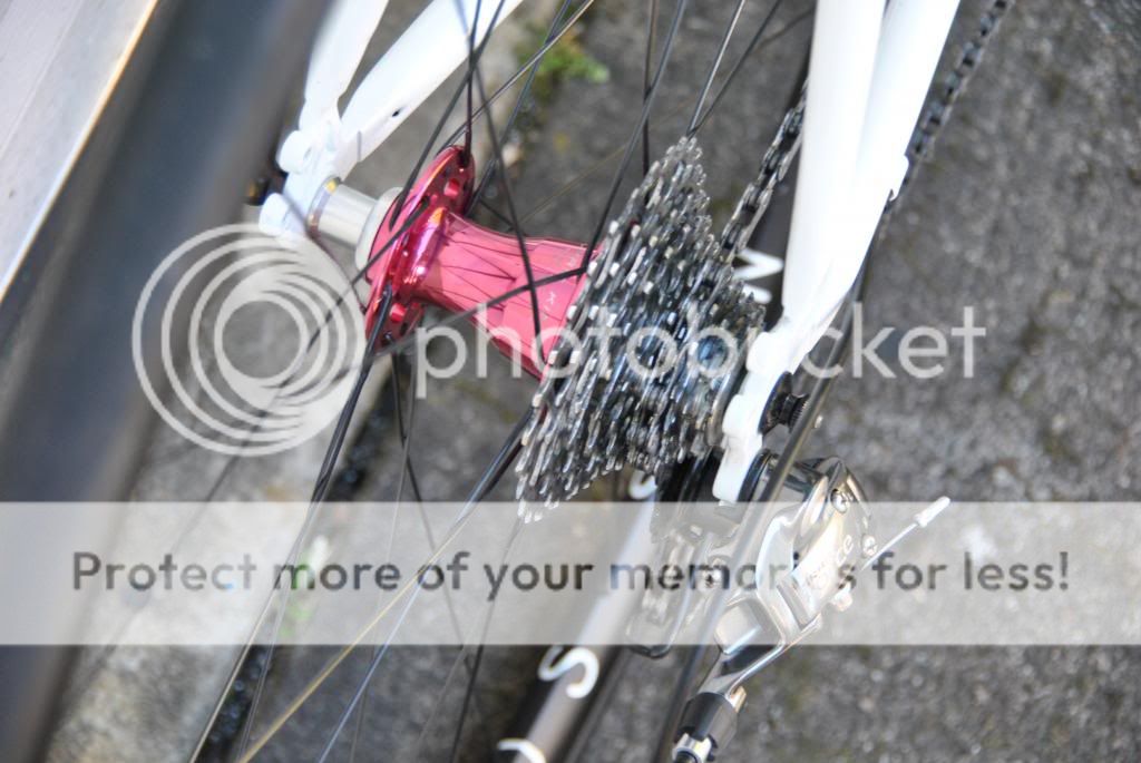

@gravity - The other bike is my Cento1... this is definitely a rain bike. I finished it on a (rare) sunny day though so fenders have yet to be mounted. CK hubs (as well as headsets and BB) are very popular here in the PNW because they hold up so well to weather and have a great warranty. As for the group - the plan was Rival but I got some fantastic deals on various bits locally. Why build *down* if you don't have to? Praxis rings because we have a lot of hills and I hate flexy rings! I bought the fork secondhand for ~$160
@Timo - these wheels won't solely be used for pissy weather, I'll use some SRAM S27s with Vittoria Pave as well.

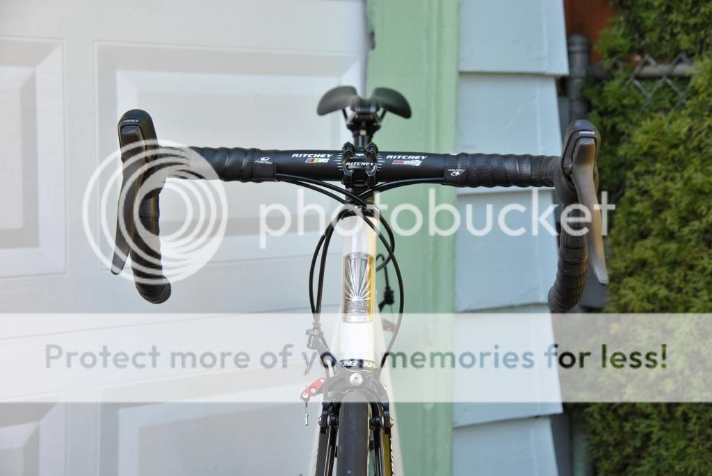

@Dallez - I did most of it with a razor blade but ended up using sandpaper. On the levers - skip the razor blade and just go for the grit! I used 400 and 600.
