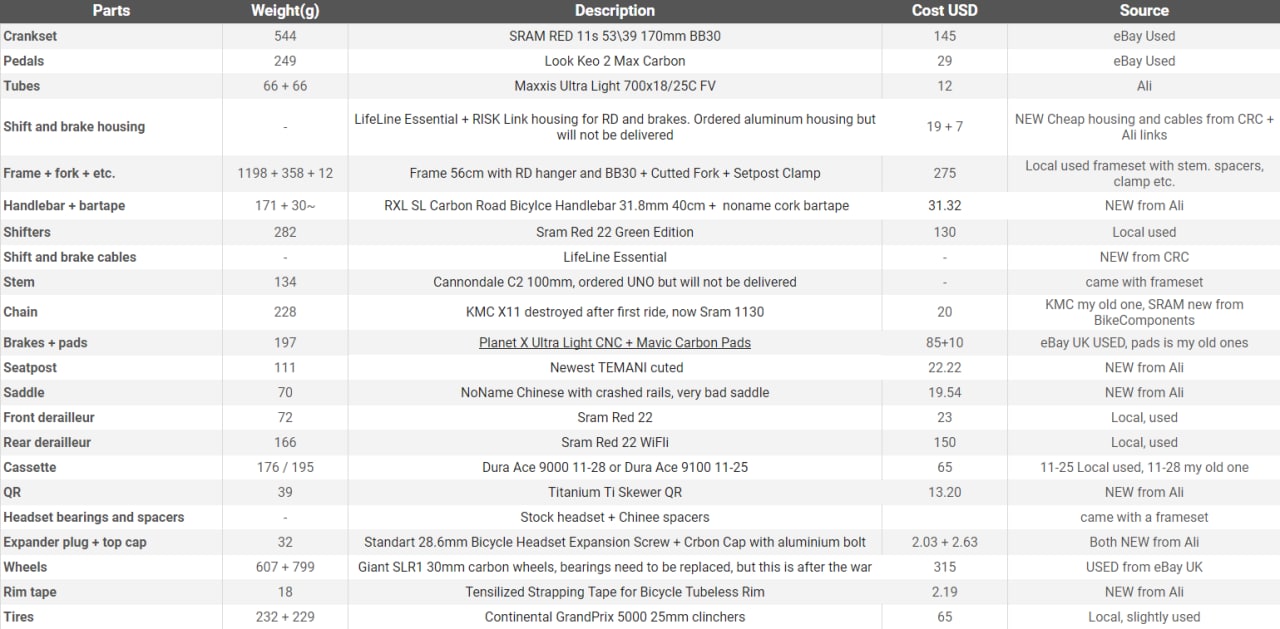

I'm finished my Cannondale CAAD12. Under 6.400g for less than 1500 USD. Not all the parts arrived, because I'm from Ukraine, some troubles with posting.
But in general, the bike is already fully assembled. I didn't weigh all the parts thoroughly, so there may be some errors, I will try to correct them later,
but the weight of the whole bike is 6.380 g with 11-25 cassette and w/o bottle cages
6.380g - 1445 USD
Seatpost - shorturl.at/ltLZ0
Fork expander - shorturl.at/afpFQ
Handlebar + bartape - shorturl.at/eiA17
Rim tape - shorturl.at/lCTY7
Link housing - shorturl.at/blzJ3
"Aluminium" housing - shorturl.at/jqBI5
Ti+carbon QR - shorturl.at/fkxLY
UNO steam - shorturl.at/mpyHK
Ti stem bolts - shorturl.at/tvLR4
Ti bottle cages bolts - shorturl.at/iHOU7
And all my love to https://www.ebay.co.uk/

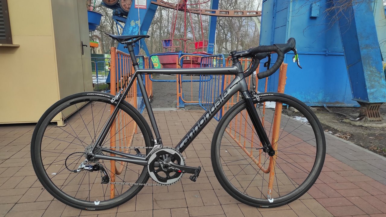

Got the crankset Sram Red 22 170mm 53\39 bb30, installed perfectly in bb30a - 544g
Сut off the seatpost, cut off the fork
Sram Red22 definitely looks good on this frame
About the wheels, I will replace the bearings very soon, but I can't straighten the wheel from the impact during transportation, in a small town there is no tool for such internal nipples, I need to order and wait
