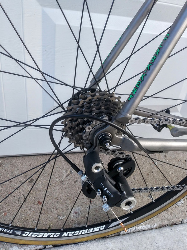

Greetings WW!
This was a fun project I put together with the goal of a lightweight build with as much titanium as possible. As pictured, the full build comes in at 6.94kg, just under my 7kg target. I am sure I could get it down further with some carbon wheels and a lighter FD, but overall I am happy with how it turned out. Thanks for looking, happy to be here!
Build details include:
60cm Clark Kent Titanium frameset
Hylix carbon fork (320g)
King headset
Cinelli Grammo threadless stem, Easton EC90 bars w/ SuparCaz wrap
Moots seatpost with Flite Ti saddle
Gutted Sram Rival carbon levers
Grafton crankset with Stronglight Zircal rings
White Industries Ti Bottom Bracket
Modolo Carbon DT Shifters
Omfega Carbon RD
Campagnolo Record FD
Americal Classic Sprint 350 Wheelset
Full Titanium drilled 8s cassette

How does she ride?

It rides well, a bit flexy compared to modern Ti, but fun nonetheless.

OP, do you have a weight list? Especially interested in the weights of the Topline/Grafton cranks, Modolo shifters, and the rear derailleur.
The Grafton Cranks, rings and chainring bolts come in at 535g
Mistral RD is 170g
Kronos shifters are 35g

Looks good, only one mistake, you forgot the Ti king headset!
Believe me, I looked, but finding one in 1" threadless would have cost about the same as the frame and fork lol
