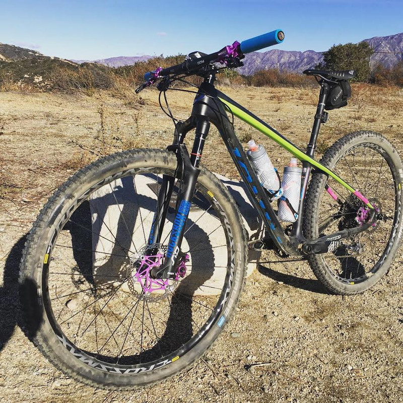

How about a Niner Air 9 RDO
I got this frameset a few months ago and built it up, spent about $3000 total and it weighs in at around 10kg
https://www.competitivecyclist.com/nine ... IwNzU5OA==
Cant beat the $1299 frame price(while they last)!

mattr

by mattr
I think import duty and shipping would probably kill it though.
