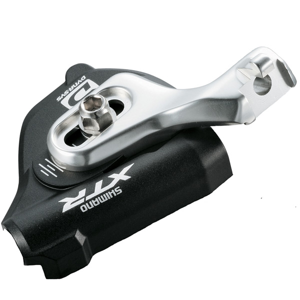

I want to be able to mate my Hope Race levers to the XTR SL-M9000 shifters using some sort of matchmaker (to save weight and achieve a cleaner cockpit).
Now, I have already asked Hope if they are planning on releasing a matchmaker for this setup, seeing as they have done so for their Tech3 brake lever. Unfortunately, their answer is no. So that leaves a few other options:
1. There is a Hope Race matchmaker for the previous generation XTR shifters (M970 and M980), see picture below.
However, the M970 and M980 shifter pods have a groove that these matchmakers are designed for:
Whereas the new M9000 shifters don't have that groove:
Does anyone think it can work anyway? Maybe if I sand down the grooves on the matchmakers to a completely flat interface?
2. Find someone who can make me a matchmaker, preferably CNC aluminium. Does anyone know how I can go about finding someone who would be willing to do this without charging a massive amount for the job? Obviously, with this solution it might be easier to design the matchmaker to work with the i-spec top cover of the M9000 shifters:
I really appreciate all input on the matter.

Can't quite work out where the groove is, but ... are the shifter covers interchangeable? If so, that could be your answer

I don't think the covers are interchangeable. If you look at the M980 cover, you see that the metal clamp can slide sideways on the cover, and there are grooves to make sure the shifter pod doesn't rotate around the clamp interface.

OK, I see what you mean.
You could file off the clamp to flatten it, but then would need something to stop the pod rotating. Epoxy resin might do the job, but adding a second bolt would be more reliable, if you can get something to fit alongside the current bolt.
