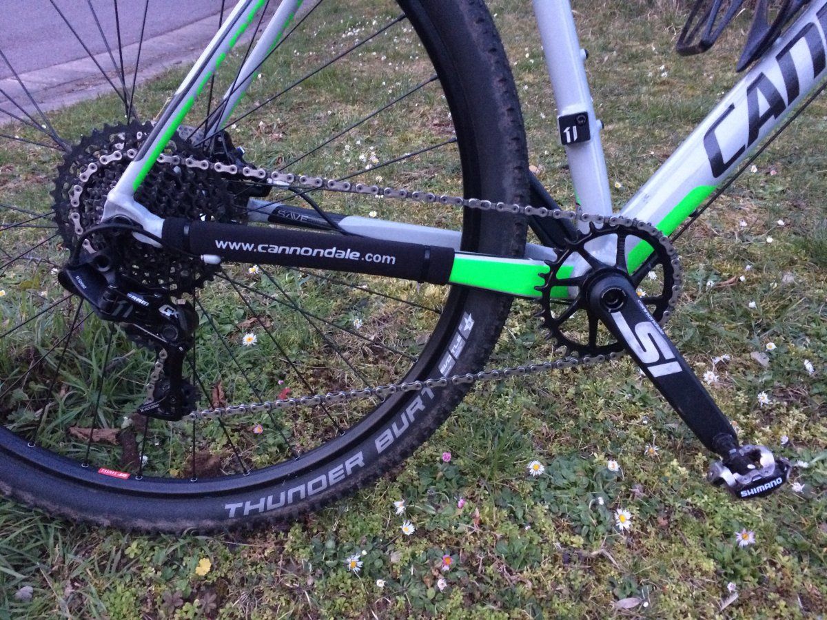

Vicpt wrote:
ChrizZZz wrote:Who has mounted a 34 Teeth Oval Directmount Chainring?
Which one fits?
Garbaruk doesnt fit. (only 32t)
ChrizZZz, i have a 34t Garbaruk oval on mine!
How does it fit? U changed some washers and have other spacer?
Mines scratched the carbon chainsuckplate only the 32teeth fits.
Now i have an absoluteblack 34t but it looks similar.
32t Garbaruk Melon
34t Garbaruk Melon

ChrizZZz
Posts: 112
Joined: Mon May 18, 2015 10:39 am
by ChrizZZz
Yep, the problem was explained some sites before.
Next try: AbsoluteBlack Oval 34. DOESNT fit. Missing 1-2mm clearence
scratching again... but a little less than the garbaruk 34t
would look nice

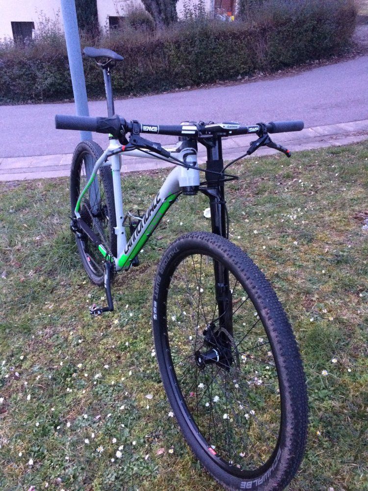

ChrizZZz
Posts: 112
by ChrizZZz
For sure. Some are riding with it and found it really stiff and direct.
Nice Training-Bike!
some Pictures of a XL
