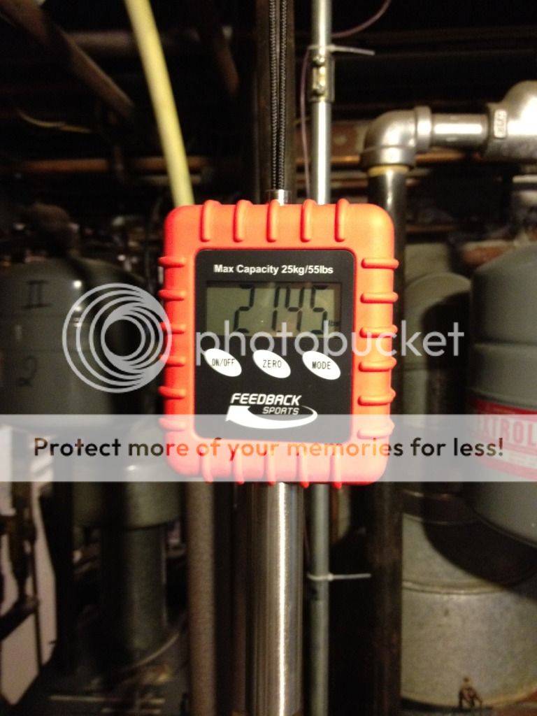

This is my Giant Nrs, it weighs in at 21.45lbs. I would like to drop 1.5 lbs. Is this possible?

You could definitely drop some weight with the wheels. You might also consider updating your suspension, with newer technologies forks and shocks are much lighter then they used to be.

alloy/ti bolts, lighter set clamp and saddle, cut off the rear brake bosses, same n SId forks if they have them.
what do your inner tubes weigh?

may i suggest going with a flat bar... a mt zoom flat can save you approx 60 gms...
grind off the brake stud bosses (as mentioned)
tune your ec90: swap the clamps for a kcnc set-up ( i got mine to 151g)...
go ti on the bolts...
Mortop headset is a scant 66gms... will prob save you abt 30-40gms
whats the weight of your wheels?
whats the weight of your rear shock?
... by the way do you have a breakdown of the weights of your parts....
might be easier to hone in on the parts that can help...
cos if your frame is a porker... than there isnt too much else to trim...
