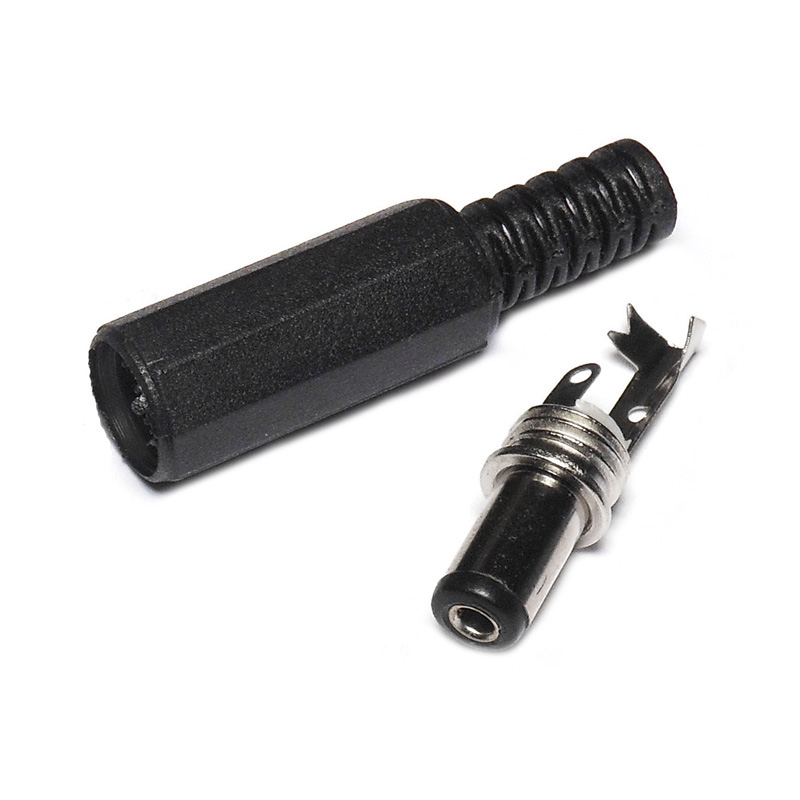

With some mediocre soldering skill, i managed to make it myself -
1) male end to EW-SD50 - inside of DC power plug + Pin
http://www.surplus-electronics-sales.co ... m%20sm.jpg
2) male end to SM-BCR2 - 2 Pin power connector http://www.technologicalarts.ca/shop/co ... e0c0c3.jpg
I do not have any quality camera to show you the actual thing. It's just a proof of concept, the connection is not as secure as preferred. i would most likely improve on it by -
1) cut and solder an extra EW-SD50 cable to micro-usb female connector (connects directly to battery, junction box SM-JC41, or shifter port)
2) cut and solder 2 Pin power connector to to micro-usb male connector
That way, i should be able to use a 3rd party charger(for charging only, 8.4V, 0.4A) as well , and the connection would be much more secure.
