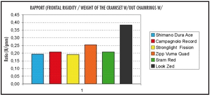

Stiffest bottom bracket or crank?
I was specifically referring to this test.
And missing this test, the crank with the widest spindle of all is the Look Zed:
In this plot, the Campy, Dura-Ace, SRAM, and Stronglight, each with similar spindle diameter, are clustered. Then comes Zipp with a 30 mm axle. Then Look is at another level with its 50 mm spindle.
