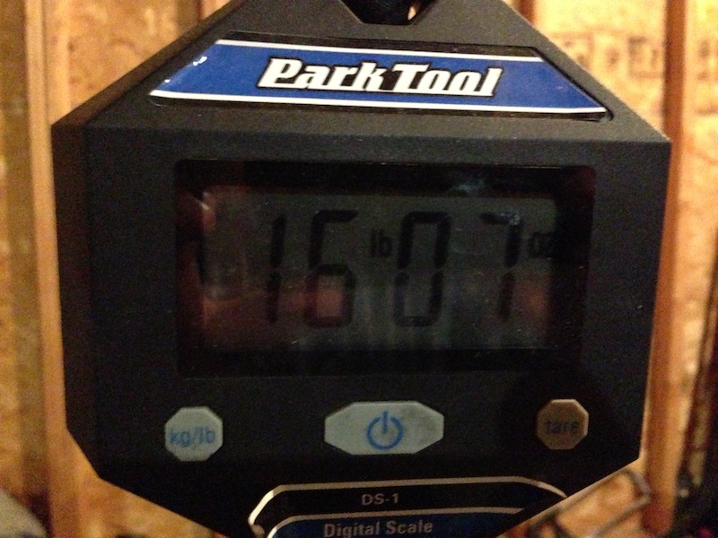

First thing I did was swap wheels:
The Alex/Syncros wheelset with Tiagra Cassette, Skewers, Tubes, Rim Strips and Conti Ultra tires were:
1210 gm front
1860 gm rear
I replaced them with a DT 1450 rear (normal tubes 100 gm, Pro4 Race tires, Ti QR)
1400 gm
... and a Fulcrum R3 Front (normal tubes 100 gm, Pro4 Race tires, Ti QR)
990 gm
and I swapped the Syncros saddle for a Romin with carbon rails which as 160 lighter.

Lastly I swapped my SR11 parts onto the bike, added pedals and a cage.
I have to keep the Tiagra crank until I get some ENG threaded SR BB cups. I think the should save another 300-400 gm.
Until then I will have to live with my bike's bloated weight.
