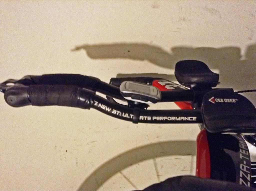

I had the same issue when I had my Garmin mounted on my stem. Bought one of these and cut it down. My hands block the air and I can easily see it by glancing down.
http://www.all3sports.com/profile-desig ... nt-xl.html
Pardon the crappy picture.

I use a K-Edge, fully extended, tilted down just a little bit, so I can look down and view it. I will try to post a photo later.
