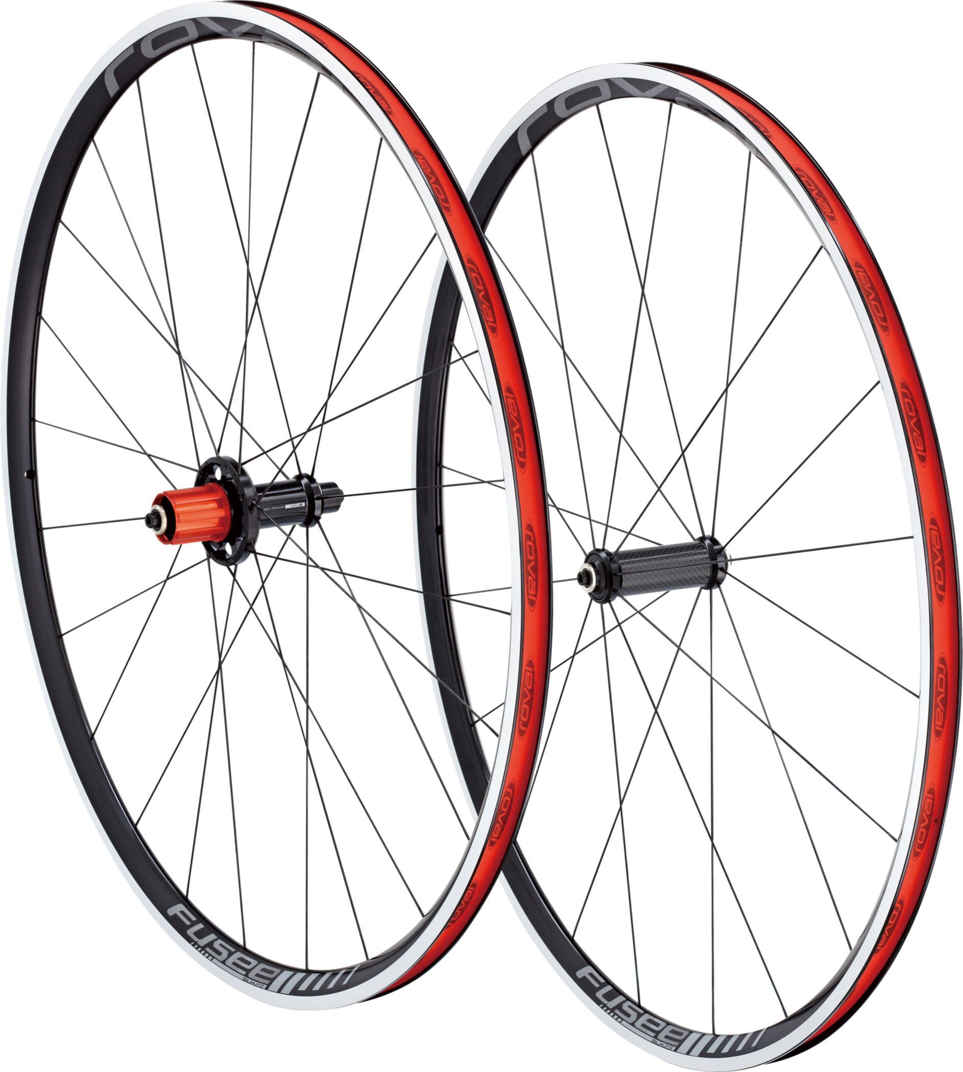

Getting a pair of H PLUS SON Archetype, and got a pair of hubs salvaged from a pair of Roval, can anyone help me out with getting the right spoke length?
The ERD for the Archetype is 595, this is my first time measuring a straight pull hub, can someone tell me how to properly measure them? Also the rear is a 2:1 so how do I get the right cross/length.
I've used the spocalc, is there anything else better out there?
Thanks
Thanks
I'd strongly recommend measuring the ERD of each rim individually. H PLUS SON recently changed the design slightly, increasing the ERD. Of the four rims I recently built, I think two were the new size and two were the old (slightly lighter) size. These were all from the same shop, ordered at the same time.
PostPosted: Mon Jan 28, 2013 5:20 pm
Joined: Fri Oct 21, 2005 4:08 am
Posts: 205
hubs i got are from this pair of roval, need to know how to get the length for the rear as it's a 2:1
PostPosted: Mon Jan 28, 2013 9:25 pm
Joined: Sun Dec 12, 2004 2:49 pm
Posts: 757
Location: Mårlset, Denmark
I'm starting a build with exactly these hubs using Reynolds Assault rims (ERD 566mm). To my knowledge there is no tool available that can calculate the DS spokes on for these hubs. I was recommended to use x2 and 32 spokes in the DT calculator and subtract 2mm to take into account the adjecent placement of the DS spokes.
For my rims which use Internal nipples I have ordered 270mm for the front wheel, 274mm for the NDS and 260mm for the DS.
Edit: I haven't build the wheels yet as I'm waiting on delivery of the spokes. I'll report back when I know if they fit.
