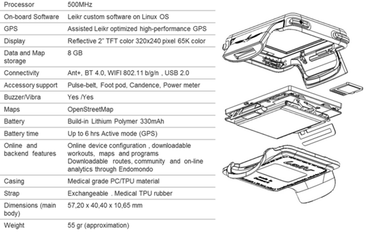

For GPS-enabled The Leikr looks to be the upcoming lightest, but (1) it's still Kickstater, which has an exceptionally high vapor rate, (2) no handlebar mount yet, just wrist, (3) sampling rate is an open question, as it's now running focused, but that's just a software matter and the software may not be fully written.
Note the 55 gram weight includes a wrist strap. 55 is basically a tie with the Edge 500 (57 g) without its mount. So w/o its strap it's probably down int he 35-40 gram range. The Edge 510 is considerably heavier (75 g, more or less).
