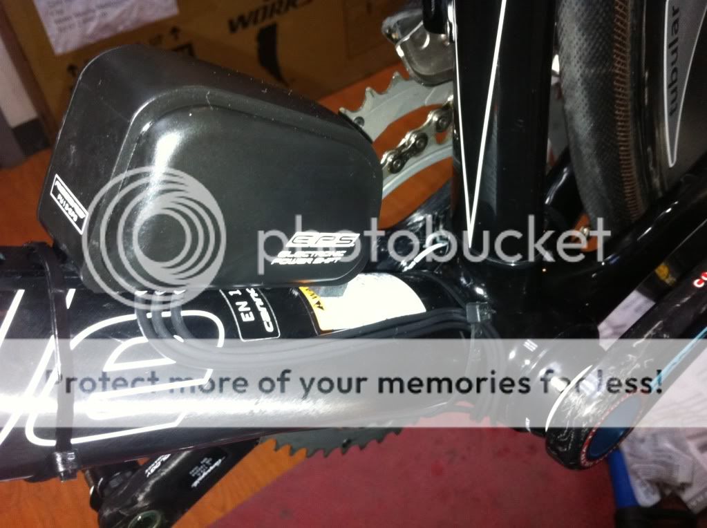

Doable but messy.
downtube.
chainstay.
bb junction.

PostPosted: Sun Dec 09, 2012 1:42 pm
Joined: Wed Feb 09, 2005 4:51 am
Posts: 1545
That looks pretty ghetto ... :shock:
Hmm... think there's a market for people to come up with kits that clean up the wiring routing for EPS there .. ?

ome rodriguez wrote:
Doable but messy.
downtube.
http://i1245.photobucket.com/albums/gg5 ... 002-49.jpg" onclick="window.open(this.href);return false;
You could use the channeled tape from Shimano to get it a lot neater than that, surely?
External DI2 set ups done like that still look icky up close, but a lot less noticeable at first glance.

I did it on my Colnago C50 frame for about two months. Like stated above. It is very messy and tacky. I used the Shimano external cable guides/tape. I helps a little but still leaves the wires exposed at the frame junctions. I was so unhappy with it that I ordered a C59 Di2 frame set to get ride of the external problem.

Obviously a Di2/EPS frame is preferable, but you can do a pretty neat job with the Shimano "U" channel wire-guide stickers I think.
Probably a bad example as I ran the wiring harness for my old SRM in the same way, and you can see a loop of it under the stem, but otherwise it's fairly tidy:
I am, of course, expecting to get flamed to a crisp now.

It's a black kit on black downtube so it's pretty neat if you ask me on your bike :thumbup:

Whoever did that job of running the Di2 cables on the bike with zip ties should have a hammer taken to his head and beaten until dead. Disgraceful. The U channel guides sold by Shimano look fine and do a very neat job of routing the cables underneath the downtube and chainstay. It is preferable if your frame is black.
PostPosted: Mon Dec 10, 2012 12:55 am
Posts: 758
Location: New Zealand
Those pics are of EPS not Di2 so not sure the EPS cables will actually go in the Shimano external guides. Either way yes, it's a fairly messy job they've done!

So does anyone know if EPS cabling will fit in the Di2 external guides?
PostPosted: Wed Jan 02, 2013 4:22 pm
Joined: Thu Nov 06, 2008 4:51 pm
Posts: 15
Location: Toronto
The Shimano tape guide fits EPS perfectly. I installed EPS externally on my Parlee Z1 in September. Very happy with performance. The Shimano tape goes a long way to a neat camouflage.
