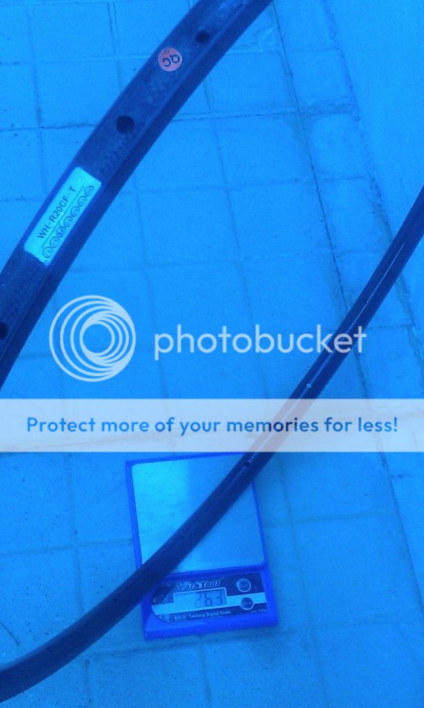

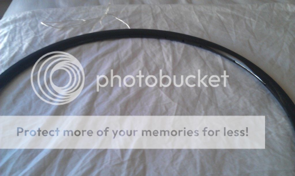

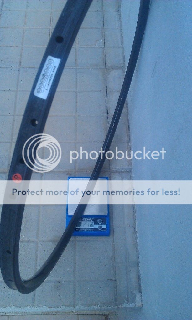

Took the decals off. Work was done by a professional, he had to scratch the vinyl off, remove the painting and reapply clear coat on. Paid €40 without any weight penalty. Will be laced with cx-rays on BHS hubs.

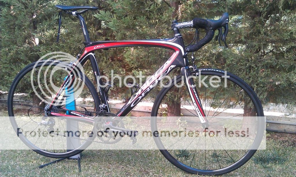

1050 gr built on the BHS hubs/CX-Rays/al nipples
