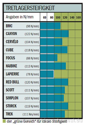

The stiffest bb measured by Zedler/tour has been the Specialized Tarmac at 72Nmm. Then there are quite a few bikes measured at 71Nmm. The Cannondale mentioned is actually quite compliant in the bb area but very stiff around the headtube where the S/W ratio is calculated.
I said has been.
A few days ago Zedler Institute measured a carbon bike at 91Nmm bb stiffness.
I said has been.
Results from RoadBike.de results from some time ago, pretty different testing methodologies if the 72N/mm is the highest value achieved
I don't agree about you comment about preferences in BB stiffness. The main problem is that with traditional double diamond frames you are coupling BB stiffness with rear end compliance, the parameter that many riders use to define frame comfort. In my book, a stiffer BB is always positive

We use the Zedler no:s because they are widely accepted industry standards. They have also tested hundreds of bikes using the same protocol for years making for a huge base if data. We don't agree on the absolute relevance on how he calculates the bb stiffness, but it is the current apples to apples test.
Comfort is indeed a different spec mainly defined by flex on the seattube / post.
But as as you know bb stiffness is not about the bb flexing but rather the down tube and chainstays bending torsionally. Also the infamous vertical compliance in the main triangle is factored in the Zedler bb flex figure. Torsional flex in the downtube may also give some bump absorbing properties (comfortableTi frames).
It's the first time that I hear about vertical compliance of the main triangle. Can you comment in detail how they factor this figure?

Zedler factors the vertical component along with the sideway component (pendulum movement) of the bb. The top tube will flex some under vertical load, yes.
