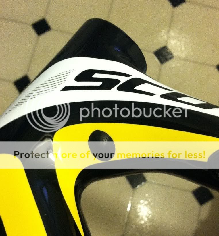

yeah apparently the R1 and the RC are the same apart from the 'DI2', and im struggling to see anything on the frame that would make it a DI2 specific frame.....the only thing is a small hole behind the BB, but its not big enough for a DI2 wire and all it seems to do is let water into the BB, and the R2 had the same small hole, i cant think why its the DI2 version as nothing is different.......
if someone has the answers i would be interested to hear them, just seems like a normal frame
On the RC there should be a plug in the Headtube junction for the cable to run through, sure that's an RC frame?

SGRAY-my pictured 54cm addict RC had no bearings installed at all or the compression plug, only hangers, does your rc have anything extra to help for DI2? like extra holes ect..??? mines 54CM and it heavier then yours :(((((( it should be the same frame?!?!?!?! any pictures of your frame please???
a plug????? from the outside inside???? like thru the headtube?, it has non of that.....

Not all RC models have the DI2 plug.

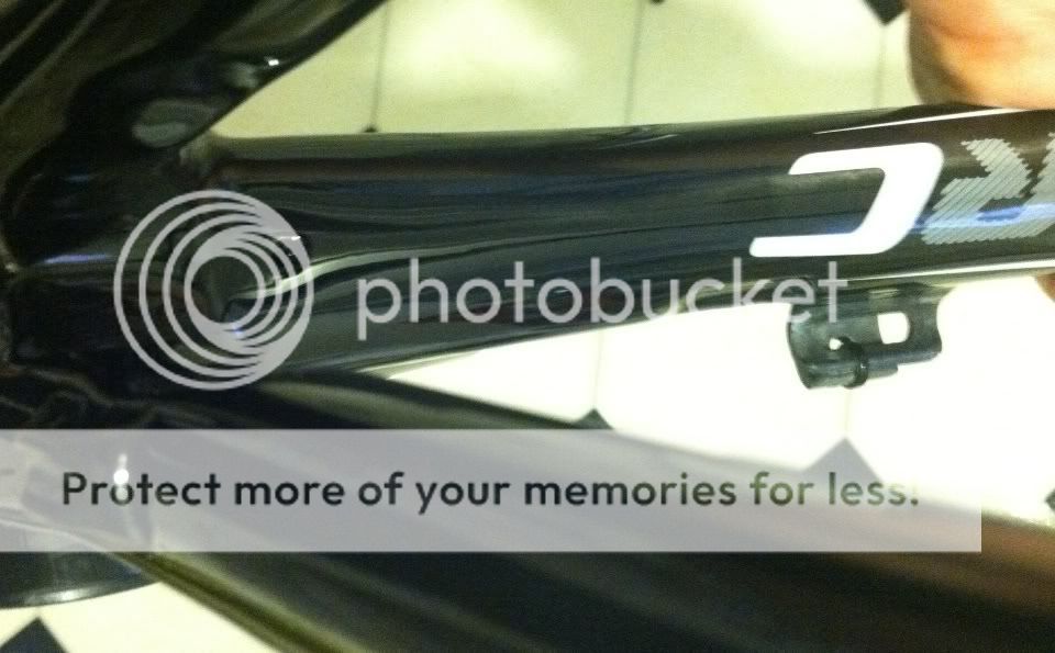

im starting to think that if i started stripping the paint back on my RC i would start finding R2 red paint, would explain why its heavier then R2 due to the extra coat of paint.
are we going to start contacting scott then?????? for an explanation????
btw you can take out the compression plug with a spoke, you hook it under and pull both bits out, i wanted to know how much mine weighed then it started slipping so i swapped it for a cervelo glue in metal sleeve star nut affair
The Addict RC should have two DI2 specific drillings. One on the left side of the head tube junction, and one on the underneath of the down tube just above the bottom bracket. Both come with plastic plugs if you're using a traditional cable setup.
Also there is the hole on back of seat-tube you describe, looks too small for DI2 wire.
