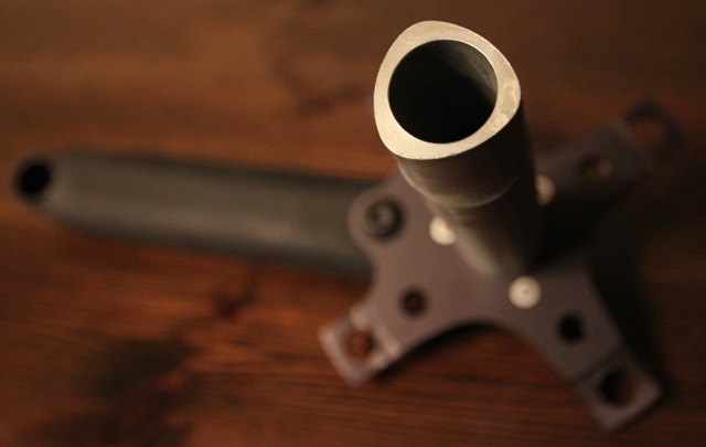

An oval axle end should be the best solution with a carbon spindle. It would be easier to manufacture too

Eric -- Oval is easy to make. I am just a bit worried about the fit which will be a bit hard to ensure due to the nature of carbon and the manufacturing process (soft cloth soaked in resin and backed in a mould, v. say CNC'ing aluminum). Especially since you need to figure out a easy way to take it out. What do you think?

Joined: Tue Nov 20, 2007 7:18 pm
Posts: 620
I don't know if you have fully understood what I was talking about
You don't need a typical crankarm/axle interface with this system that would be much more difficult to do in carbon
