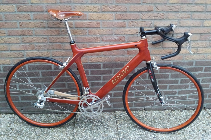

I almost got the bike built up yesterday. Unfortunately Shimano was kind enough to include a pre-cut cabel set. And since they cut the front derailleur cable nice and short, I was unable to guide it trough the top tube. I won't be able to get a new cable until next week, so that sucks a bit, as I was hoping to ride the bike in club ride today.
Here is a (crappy phone) picture of the bike when it was almost finished. I hope you like it!
My Renovo R1 wooden bike project
Check it out: the most amazing vintage Colnago, Merckx and Pinarello collection
PostPosted: Sun Mar 04, 2012 3:30 pm
Joined: Sun Dec 19, 2010 4:24 am
Posts: 43
Amazing!! Looks really good.
Two questions:
1) which pedals did you end up using, I thought you didnt like the 7700 ones?
2) is the renovo on the dt a wood inlay?
Thanks, great job!
PostPosted: Sun Mar 04, 2012 5:06 pm
Posts: 657
Location: PeAk District
Lovely, I still think that those wheels are absolutely the b@ll@cks(and the conti's look great on them). First impression is that it needs a silver cockpit and a polished steel fork (to lose the black). Or could you get the fork painted in chrome...?
Brilliantly imaginative build though, an inspiration to us all, thank you.

@Stefano: I plan use the 7700 pedals. I know they do not have a good reputation, but I can always switch them if I don't like how the work. For now I plan on keeping as many parts DA 25th as possible. The 'Renovo' is stickered on, but it does look very nice. I will upload some extra pictures of the finished bike next week.
@bencolem: I am not keen on the cockpit as it is either. I already stripped the stem (Deda Zero 00) of it's logos, but still it is not quite doing the job for me. The reason for this could also be the fork, or of course the seatpost. The idea of polishing the front end did cross my mind, but I think it will make the bike a little bit too bling bling.
