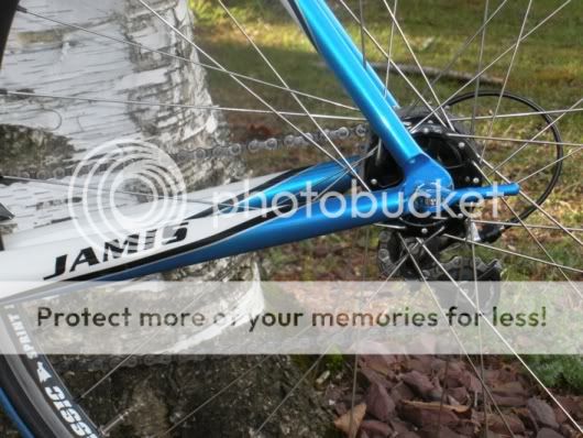

You'll only need one coat for PC. Looks up some videos on how PC works, powder particles are applied to the object with electrostatic charge, then heat is applied to cure the plastic particles. This cycle is not repeated. The thickness of the powder layer is what will determine the weight of this coating as well as its ability to withstand abrasion.
Edit: here is a pic showing rear skewer I PC'ed which happened to match the paint pretty well (since have been blasted and pc'ed black to
match my Tarmac).
