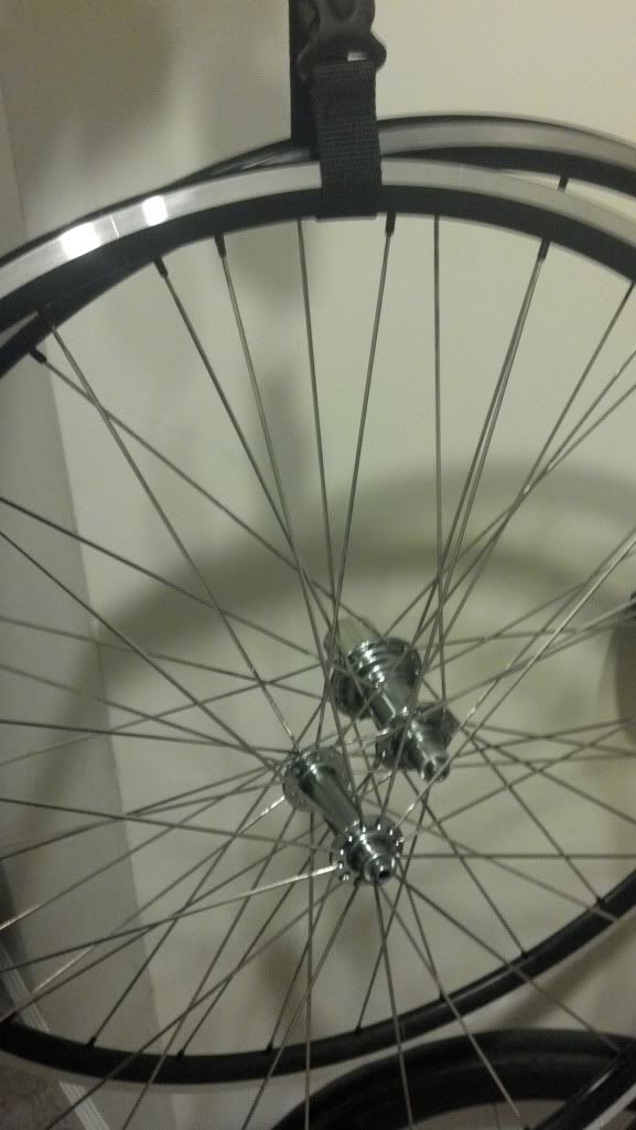

I know a lot of people seem to ask about lightweight aluminum clinchers from time to time. So, I thought I would post my most recent build here.
Me: 6'4" 195lbs. Sprinter and generally suffer on the climbs. I was looking to build a cheap, light, and reliable (yeah....I know) aluminum clincher wheelset for the road races.
Budget: $500 (all-inclusive)
Build:
Stan's 340 Alpha Rims (24H/28H)
Bikehubstore.com Superlight Hubs
Sapim CX-Ray Spokes
Brass Nipples

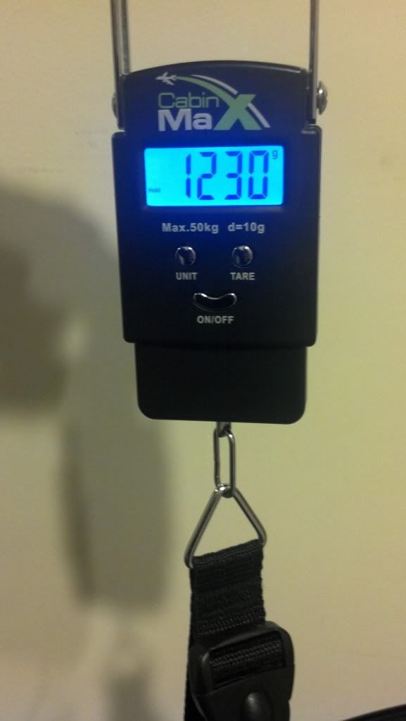

Total weight: 1230 grams (verified on my luggage scale and a Park scale at my LBS). More weight could obviously be saved with a lower spoke count. A 20/24 build would be sub-1200 grams.
Total cost: $502. This includes all shipping, labor and tax. The wheels were built by a very experienced wheel builder at my LBS.
Thoughts: I am sure there are cheaper options out there, but this is the cheapest and lightest that I could put together that would be reliable at my weight.
I debadged the rims because the graphics that came on them were hideous

Will be nice to know how those go for you....if you don't rip them apart....your builder is good.

Haha. Well these are not going to see any crit work, so I am hoping for at least some longevity. Although I put down a pretty good sprint (wattage-wise), I really haven't been too hard on wheels over the years. However, I generally am riding 50mm+ deep carbon wheels. I fully anticipate a noticeable decrease in stiffness if I get on it.

I'd love to hear your feedback on the rear wheel when you get some rides on it. I'm the same weight and also put down some decent power. Rebuilding my rear wheel in a couple months (same spoke count and hub as yours) and have been mulling over using this rim. I'm using a 28h xr200 in the front and that's light/stiff enough for me. The rear will either be that Stans or an xr270, depending on how soft these end up being. I've been having a hard time tracking down feedback on these rims amongst the heavier folk.

Hi Snowstorm, very nice ... do you think it would have been ok to do a 28H rear and 20H front for your weight?

Nice build there at a good price. I've just gone for a similar build, not received yet but hoping for about 1175g to 1200g max. They've cost £700 from Just Riding Along in Sheffield. I'm about 172lb's and not a sprinter :wink:
Build:
Stan's 340 Alpha Rims (20H/28H)
Tune Mig70 Mag170 Hubs
Sapim CX-Ray Spokes
Alloy Nipples

I will look forward to your experience with the rear 28H. I have built front wheels with the Alpha 340 with great success. I have held back from using the BHS rear with the Alpha 340 due to the combination of flange spacing/low max tension seemed to provide NDS spokes with too low tension for my taste.
