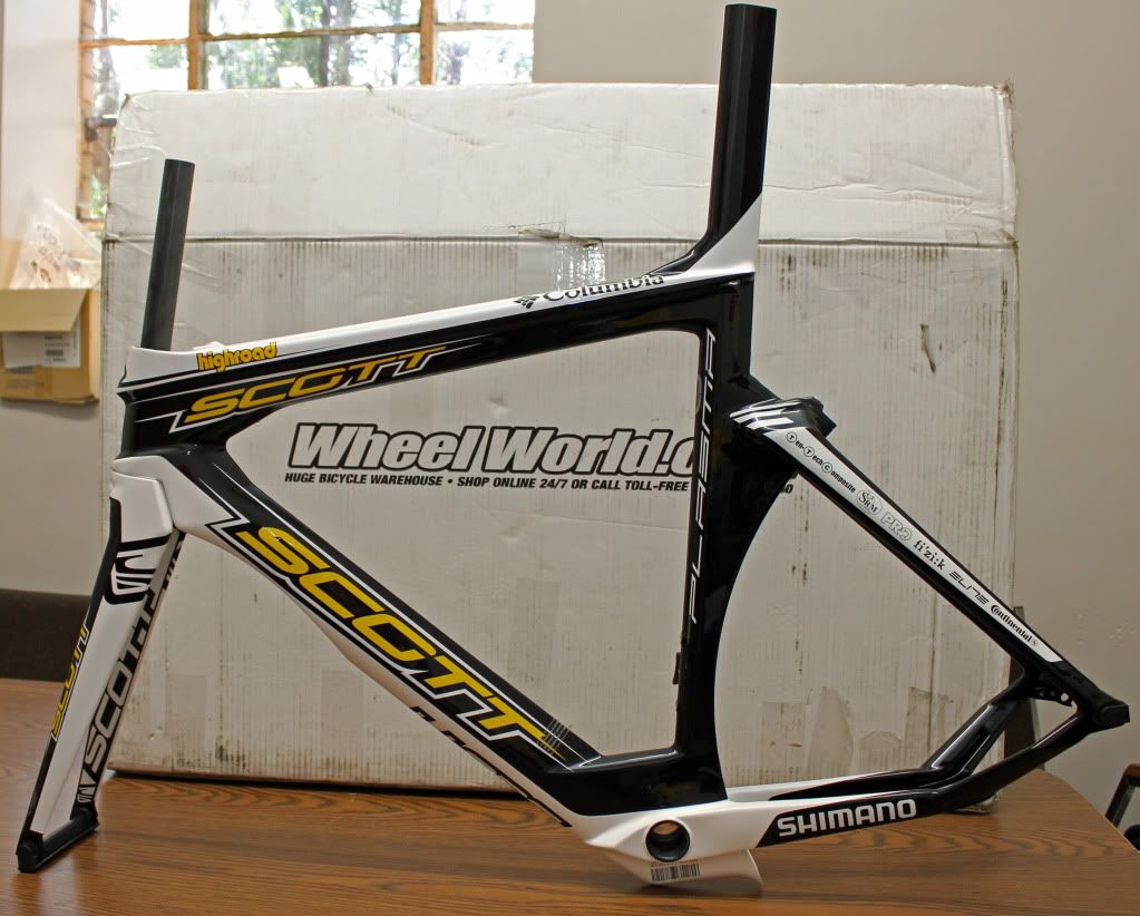

Well, I convinced myself to get a TT bike for racing next year. My goal was to stay on a reasonable budget while still getting the most aero (and weight) benefit out of a setup that I could. I'd been looking at slightly used framesets (09ish P3s, Transitions, etc.) or chinese unbranded when I came across some new, old stock, 2009 Columbia Highroad Plasma 2s on ebay. I couldn't pass it up.
Here's the build list so far:
09 Scott Plasma 2 Frameset sz.54 @2,061g (frame, fork, seatpost, headset incl. in weight)
Zipp Super 9 @1,000g
Hed 3 Front @750g
Far and Near Skewers @41g
Veloflex Extremes @460g
Uberhund Blitz Aerobar w/ 295mm ext. @468g
3T Team Stem @119g (90mm, -17)
SRAM TT900 Shifters @143g
SRAM Force FD @86g
SRAM Force RD @172g
SRAM Red TT Crankset @752g (54/42 with SRAM TT Chainring)
SRAM OG1090 11-23 @153g
KMC X10 SL @230g
SRAM TT900 Brake Levers @97g
Simkins Egg Brakes @285g (includes original pads)
Corima Brake Pads @10g
Prologo Nago Evo TTR Nack @189g
Speedplay Zero w/ Ward Spindles @163g
Origin 8 Bar Tape @25g
Arundel Chrono Bottle Cage @35g
Expander, Bolt, Top Cap @19g
Cables/Housings @183g
Total = 7,441g
EDIT: Updated weights/parts in bold. Zipp Super 9 and SRAM TT crankset on the way!
