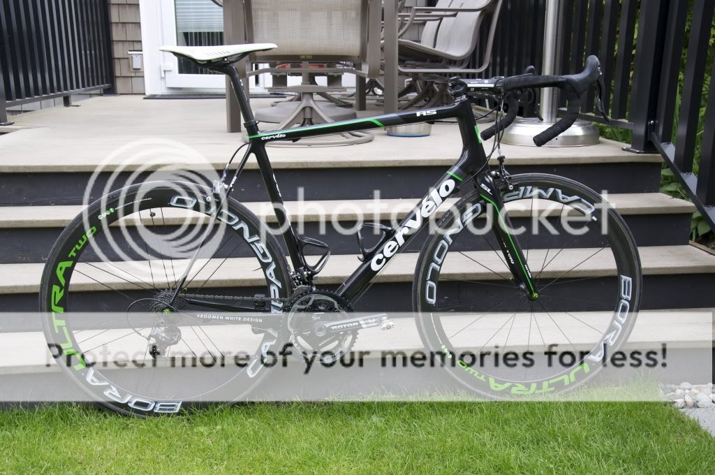

I have the power meter installed & it is working fairly well - I talked to rotor & they had some issues with the chain falling off the big chainring when big to big. They are sending me a new one - other than that it works great & I am loving training with power.
ps - the white seat is going to be changed for a black one
