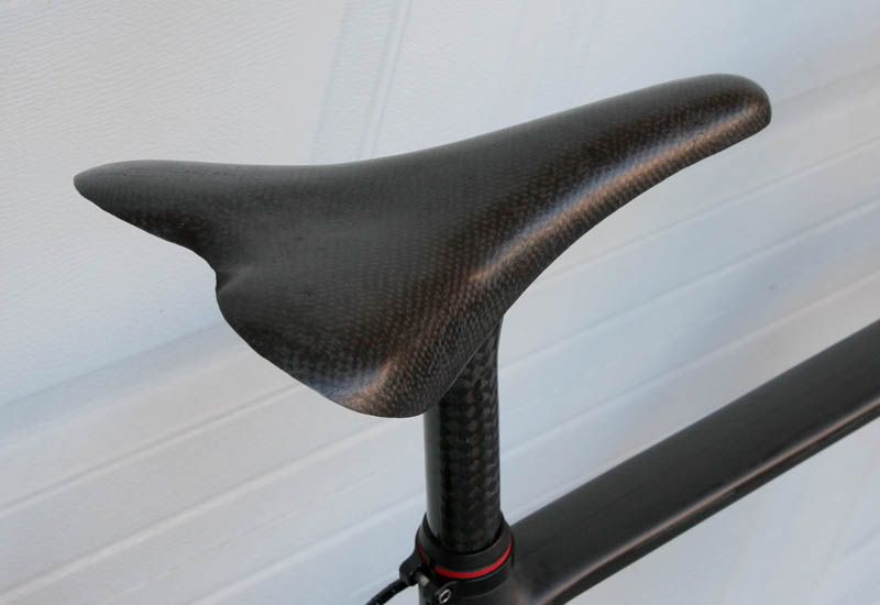

New saddle:

Yes, I have been running my Cinelli RAM bars with chopped drops--so I know how I use them (or not) and so...saved 20g or abouts (old skool WW - cut off everything you never use!)
The seat and post are just for the photo--I have my own integrated seat/post that I will be using (125g), but to your question--yes, I did the Alien in red myself to add a little red highlight theme to my bike when I used this combo. I won't be running so much red on this build, but there's enough on the FSA Plasma bars to need a little on the frame. The headset is a shaved FSA Orbit (1.5" of course) and I added the red ring just for bling.
dr Phil Gandini
