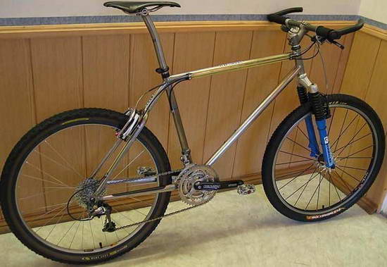

The lightest complete set here is submitted. I use it only in Moscow country region. Photo here: http://www.bike4u.ru/images/content/kletka_bike.jpg
Picture is not updated! In a new easiest 19 lb complete set, other stem, other cassette, other wheel and tyres, there is no computer, brake amplifier, bar ends, on a fork there are no rubber covers (boots).
