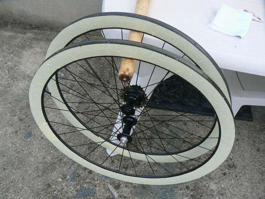

I read the pain you had with aquasure going on the rim, so I applied a "special curve" tape on the rim before gluing/aquasuring and i had no problem.
It look likes that (i took the tip from julmtb forum, not my wheels on the picture) :
In fact it was just 1000x harder to put the tubular on the rim (the final 15 cms) than put the aquasure :?
