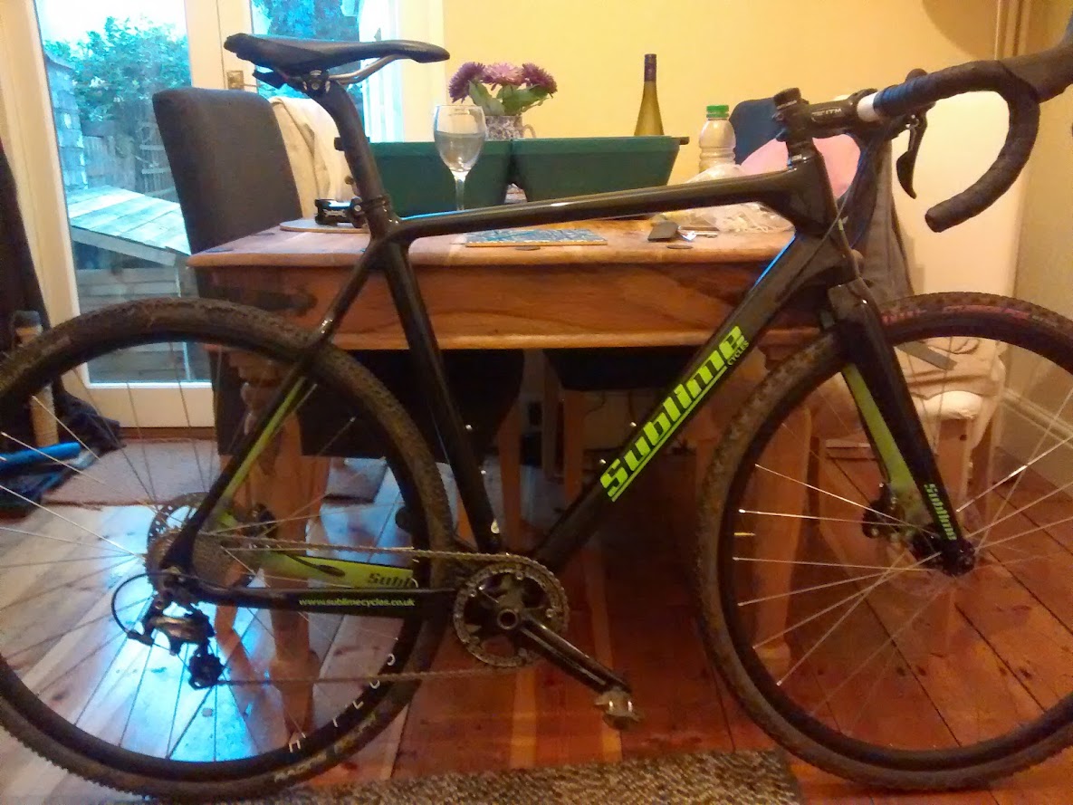

I finally got my IP105-D built up
Running rs685 hydraulic brakes, 1x11.
h son Archtype + novatec
also a set of tubs : BOR xmd 309 on novatec hubs
Have found no overlap issues. Think i'd like 172 or 175 crank
Rode a very muddy cross race sunday and chain stayed on fine (and this was running a 10 speed powerlink with on an 11 speed chain)
