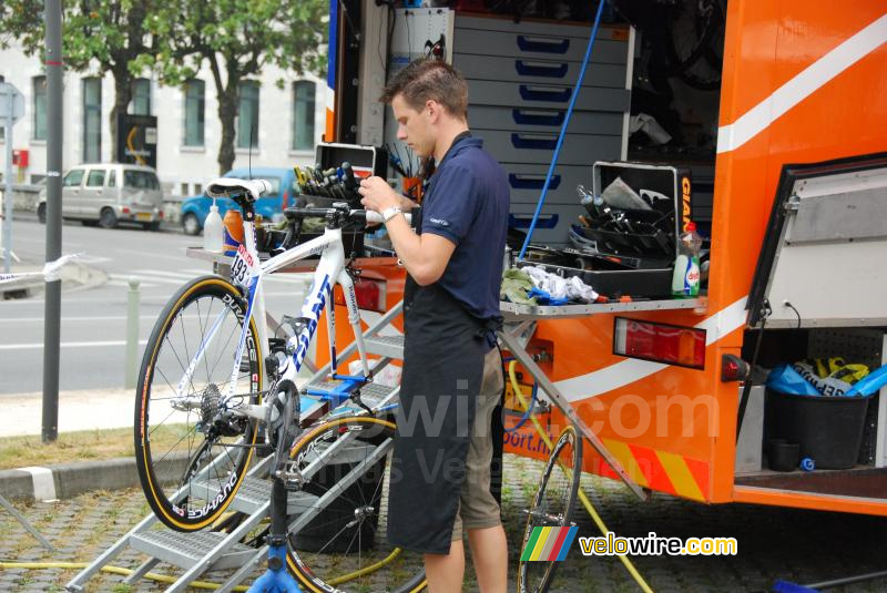

Oscar Freire has to be one of the kings of the slammed stem. Rabobank mechanics had to make a custom topcap to run that stem so low.
http://www.velowire.com/watermark_photo.php?ID=8966
