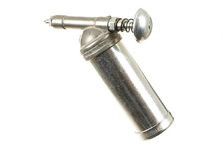

I use an inexpensive Dualco grease gun (see pic below) to lube my frogs. It has a short, needle-like tip, and it works quite well.
For grease I use white lithium grease that I purchase at the local big box hardware store. At some point, however, I must have purchased some crappy grease, because one of the frogs all but seized. Upon disassembling the offending pedal, I found that the grease had hardened to Silly Putty (or modeling clay) consistency. After wiping everything clean and re-greasing, it's been fine.

I just use my standard gun with a needle tip from Ace Hardware. Bulk tubes of marine wheel bearing grease as speedplay recommends. Very easy and I do it about once every 3 months which is overkill. I like to over maintain my bike.
