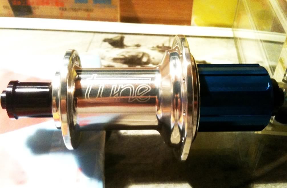

hi, I just got my MAG170 from starbike (172g)
I would like to know how to remove the right aluminum cap as mentioned in the instruction?
Just pull it off. It's not threaded it's just press fit.
thank you, but it is too tight for me to do it by hand.... :noidea:
