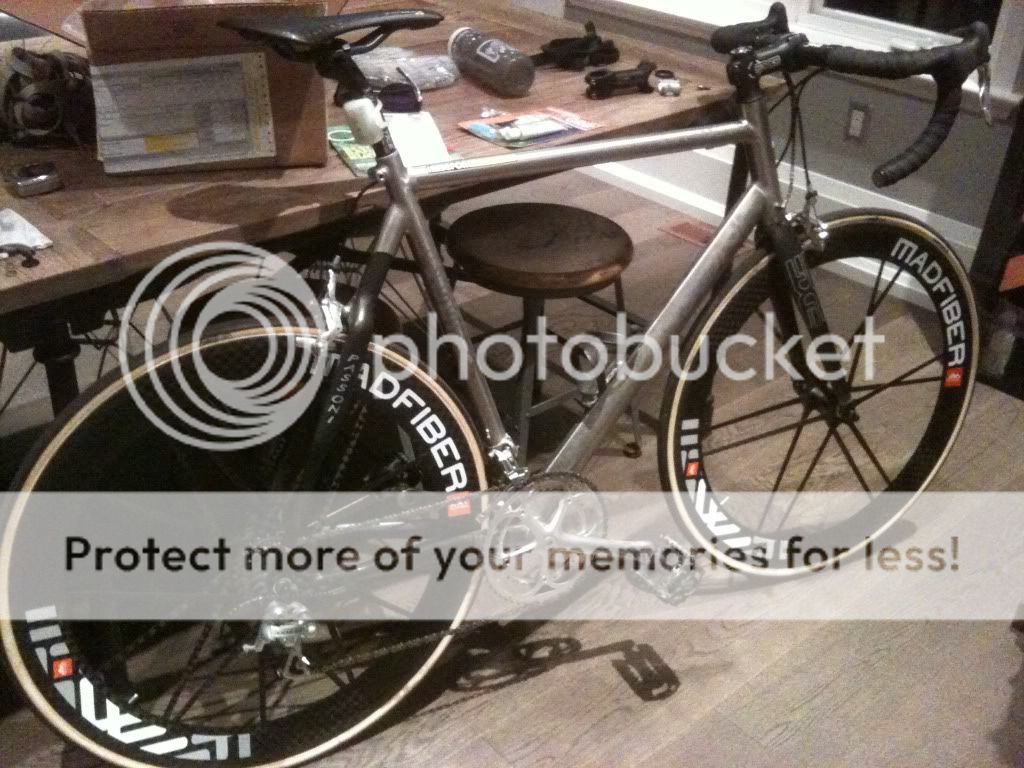

Blog has been updated with a ride report and further pics:
http://mikesbikeparts.blogspot.com/2010 ... anada.html
Here are the wheels on my Passoni:
Best,
Mike

What is the actual rim depth?

Rim Depth = 60mm front, 66mm rear
Seriously light for that degree of aero-ness, or is it aero-osity?

this is a lot of surface area between the flange(star pattern facing inside) and the spoke. done right i wouldn't question its integrity.
the spokes are at least .070" thick and at ~ .5" width they can take a lot.
what i dont get is how they are attached at the rim. does it penetrate the rim?

From my understanding in discussing with MF guys prior to purchase, the spokes penetrate the sidewall at the interior diameter of the wheel and are then bonded to the inside of the sidewall all the way to the rim. This would result in a bond appromately 50 mm long and 10 mm wide...pretty beefy...

Yes, that's approximately correct. In addition, a piece of scrim is added over the spoke end, adding additional strength to the bond.
I believe the spoke has a T-shape at the end which increases the bonding area further, and the adhesive is an epoxy used to assemble carbon wing assemblies on military aircraft.
