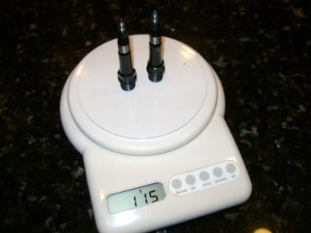

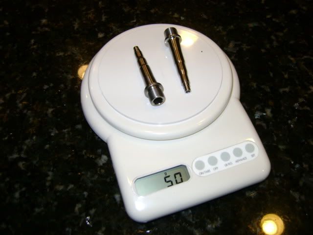

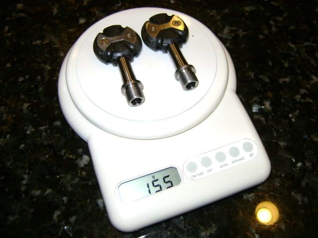

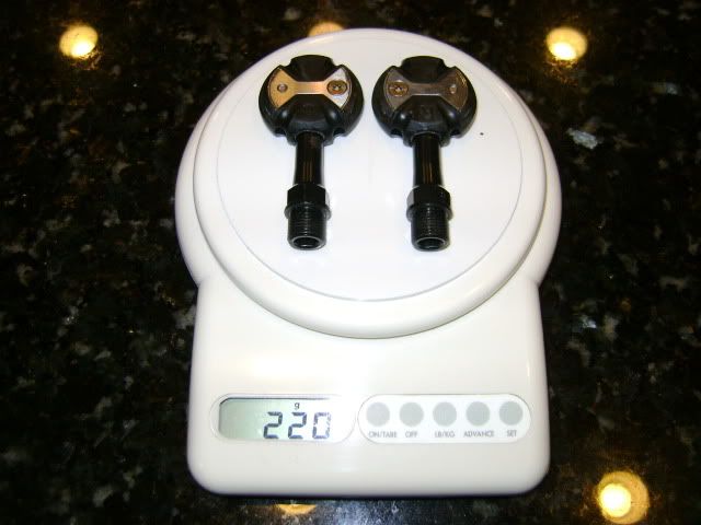

Long time troller, first time poster. Thought I'd share a Winter project on some Speedplay Zeros. Wanted to switch from Keo Sprints to a nice set of Zeros. The total cleat/pedal weight on the SS and ChrMo Zeros was more than the Sprints. So bought a slightly used pair of Chromoly Zeros/cleats for around $90 on Ebay and bought a set of titanium spindles of a nano design, but machined for std Zeros for around $60. (Mr. W....does VERY nice work.)
Anyway photos tell the story. Got a set of Zeros that look like Nanos, weight slightly less than stock Zero Ti's for around $150. Happy.
STOCK Zero Chromoly
Chromoly Spindles
Titanium Spindles
Assembled pedals
