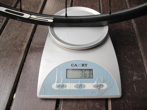

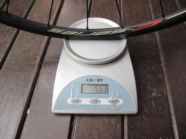

Here's my take on this topic.
Front- 363g
Rear- 551g
Total- 914g.
20/24. Made with our Prodigy V3 hubs with steel bearings. Alloy nipples and Brass RDS. Would be sub 900g with ceramics and full alloy nipples.
Front
Rear
