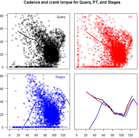

If you get a chance, here are two things we did. First, cadence indoors and out:
Second, for the outdoor ride, a comparison of rpm and crank torque. RPM is on the x-axis, crank torque (in Nm) on the y-axis.
