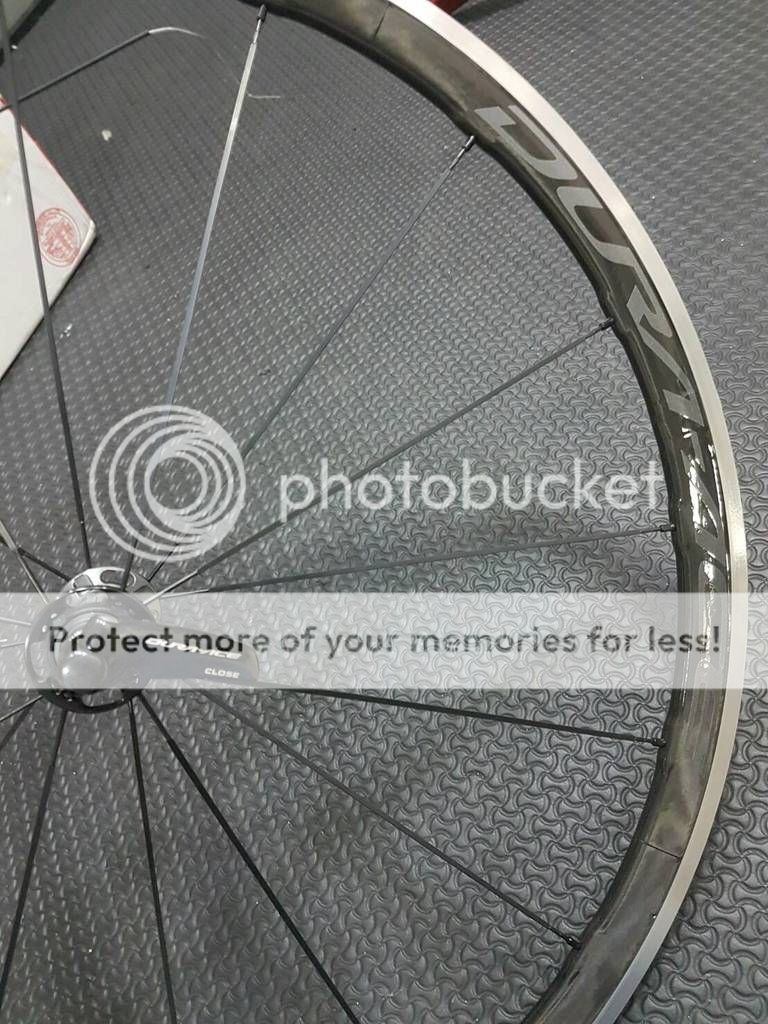

Last 2 weeks I purchased Dura-Ace C40 wheel set from authorised local dealer and found that there's something wrong with my C40.
I found that my C40 rim dimensions are not match with what Shimano describes on its website. My C40s rim depth and width are smaller and they are same as C35s rim.
Rim Width should be 24 mm (17C) with Rim Depth 37 mm.
and what I could measure
I have contacted local distributor in Thailand and They have been investigated and found that all of C40 wheelsets that they import got the wrong specification.
They contacted Shimano Singapore which is headquarter of region southeast Asia in order to find out what happen with these C40s last week. and no response yet till now.
What happen with them?
and Its dimensions are same as C35 exactly ??

Wow. I just subscribed to the thread. Please let us know how things go with this. Can you post an image about the side of the rim and the stickers on it?

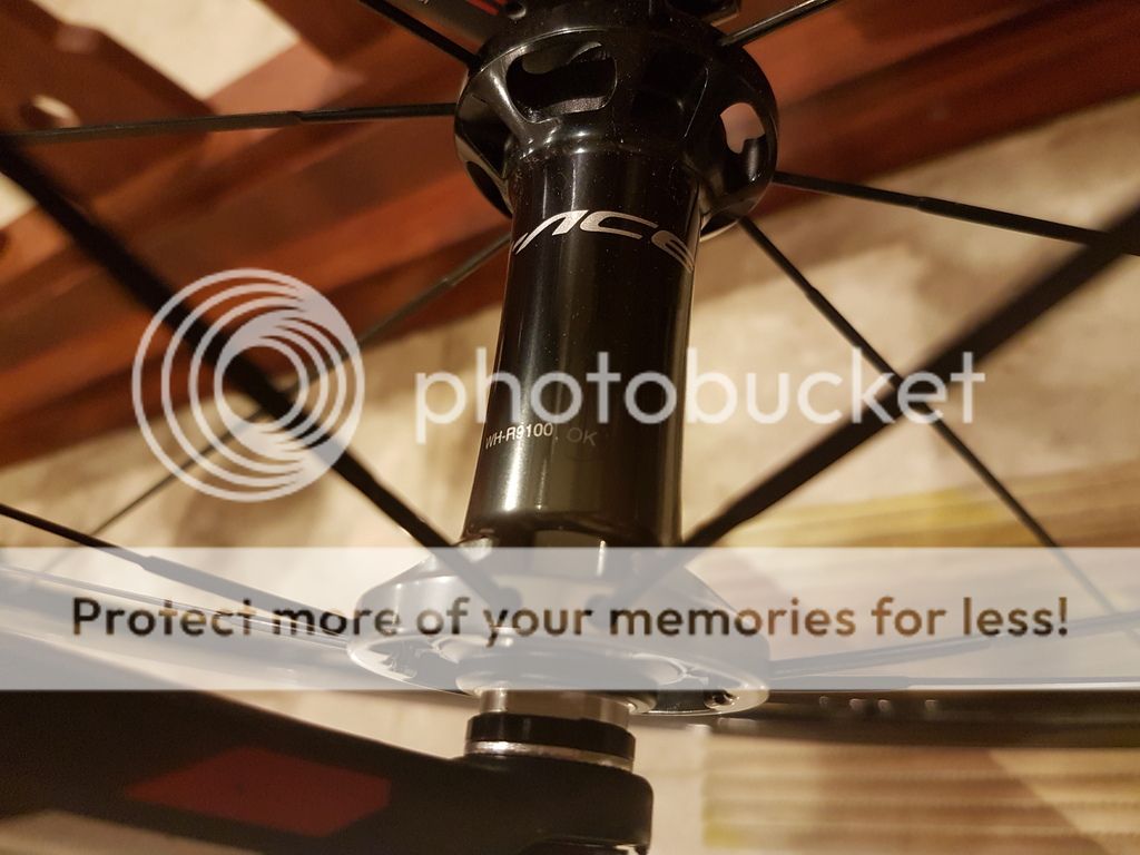

It's rim and hub, WH-R9100

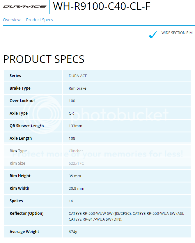

WTH !!!
They just updated their website !!!
Rim Depth 35 mm and Width 20.8 mm ???
It should be C35 WH-R9100 then....not C40 !!

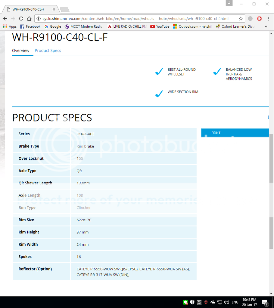

Shimano EU website still lists as C40 spec. LOL
http://cycle.shimano-eu.com/content/seh ... -cl-f.html
hatcha23 wrote:
WTH !!!

oh but they forget to update rim size to 15C. LOL
http://bike.shimano.com/content/sac-bik ... -cl-f.html
What is Shimano doing????

Shimano EU website also updated C40 spec sheet without notice.
I think they want to sell C40 with C35 rim diameter.

Online spec was wrong for a period of 30.06.2016-31.12.1016
Online spec website information was updated on xx.01.2017
you can download older revision of specs from shimano website to see it:
specification revision 1.8 - June 30, 2016 - H=37mm
http://productinfo.shimano.com/download/pdf/spec/1.8/en
specification revision 1.9 - July 19, 2016 - H=37mm
http://productinfo.shimano.com/download/pdf/spec/1.9/en
specification revision 2.0 - July 22, 2016 - H=37mm
http://productinfo.shimano.com/download/pdf/spec/2.0/en
specification revision 2.1 - August 10, 2016 - H=37mm
http://productinfo.shimano.com/download/pdf/spec/2.1/en
specification revision 2.2 - September 2, 2016 - H=37mm
http://productinfo.shimano.com/download/pdf/spec/2.2/en
specification revision 2.3 - September 27, 2016 - H=37mm
http://productinfo.shimano.com/download/pdf/spec/2.3/en
specification revision 2.3 - January, 2017 - H=35mm
edit: actual dates, thanks hatcha23 for correction (reference: next page of this thread)

C40 - tubeless clincher disc thru-axle in size 37mm, rim brake in size 35mm
C60 - tubeless clincher disc thru-axle in size 60mm, rim brake in size 50mm
both C40 and C60 have wrong information about rim brake version until at least 31.12.2016
W=24.0 H=37 front=669g rear=832g - WH-R9100-C40 info v1.8-2.3 (30.06.2016-31.12.2016)
W=20.8 H=35 front=674g rear=830g - WH-R9100-C40 info v2.3 (xx.01.2017)
W=24.0 H=60 front=800g rear=889g - WH-R9100-C60 info v1.8-2.2 (30.06.2016-31.12.2016)
W=22.4 H=50 front=832g rear=1019 - WH-R9100-C60 info v2.3 (xx.01.2017)
W=20.8 H=21/24 front=585g rear=804g - WH-R9100-C24 info v1.8-2.2 (30.06.2016-31.12.2016)
W=20.8 H=21/24 front=618g rear=835g - WH-R9100-C24 info v2.3 (xx.01.2017)
