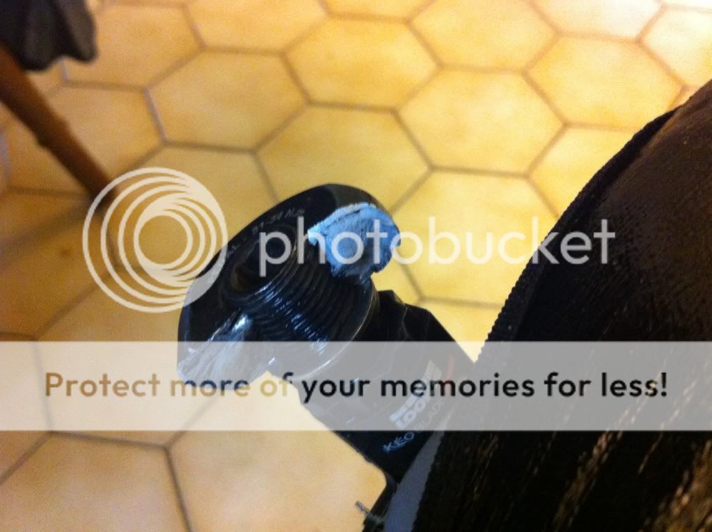

Riding along today in the wet and crack, got up out of the saddle to sprint and my Rotor 3DF crank cracked and broke at the threads. I was left with the remainder of the right crank still attached to the pedal and I was left to ride home one legged.
Looking at both ends of the break, one side is clean metal, the other side looks corroded like there has been a crack in the metal or an imperfection in the metal at time of forging.
Was lucky to stay up right and the jagged end of the crank cut my overshoe and leg! Thanks Rotor!

Looks like a fatigue failure. In the second photo on the right hand side at the bottom by the threads is where the crack started. You can see the bands radiating out from that point. That shows how the crack grew. Then the bands stop and the surface becomes rough. That is the final bit of metal that was hanging on before it suddenly broke. The crack was there for a while, slowly growing each time you pedalled. Usually these things start from a small imperfection in the surface. It could have been there from the factory, or it could have been damaged sometime later. Hopefully you get it covered under warranty!

Do you have picture of the side of the crank arm?
Whats on the side of the crank arm in the last pic?
Has it been crashed on before this incident?

Happy to report that Rotor replaced my 3DF crank and spider with a brand new one immediately no questions asked.
In the interim I upgraded to a 3D+ so now have a brand new in box BB30/BBright 110BCD 175mm to sell if anyone is interested.

No, nothing mentioned with regards to the cause. They just supplied me with a new crankset without asking for anymore description of the events when it failed.
Unless it happens regularly, which a quick trip to google reveals it doesn't, I wouldn't worry. It was probably just an inperfection in the forging process or an issue when the threads were tapped in the crank.
