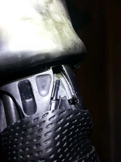

In regards to the cable snapping issues I had 9000 cables installed on my 5700 group for 6 months / 4500 miles. I saw a thread like this on another forum and decided to inspect the cables. I peeled the hoods back and my RD cable was badly frayed. The FD cable looked new but I don't do much front shifting. I had my shop install the older PTFE cables and SP41 housings. I miss the light shift action of the polymer coating. The PTFE cables easily take twice as much effort to downshift the RD. This leads me to believe 80-90% of the improvement in shift quality on 6800/9000 comes dowwn to the polymer coated cables. I'm not in a big hurry to upgrade to 6800 anymore until Shimano fixes the polymer cables.
Here's a pic of the RD cable (it's Google+ so I hope it shows.)
