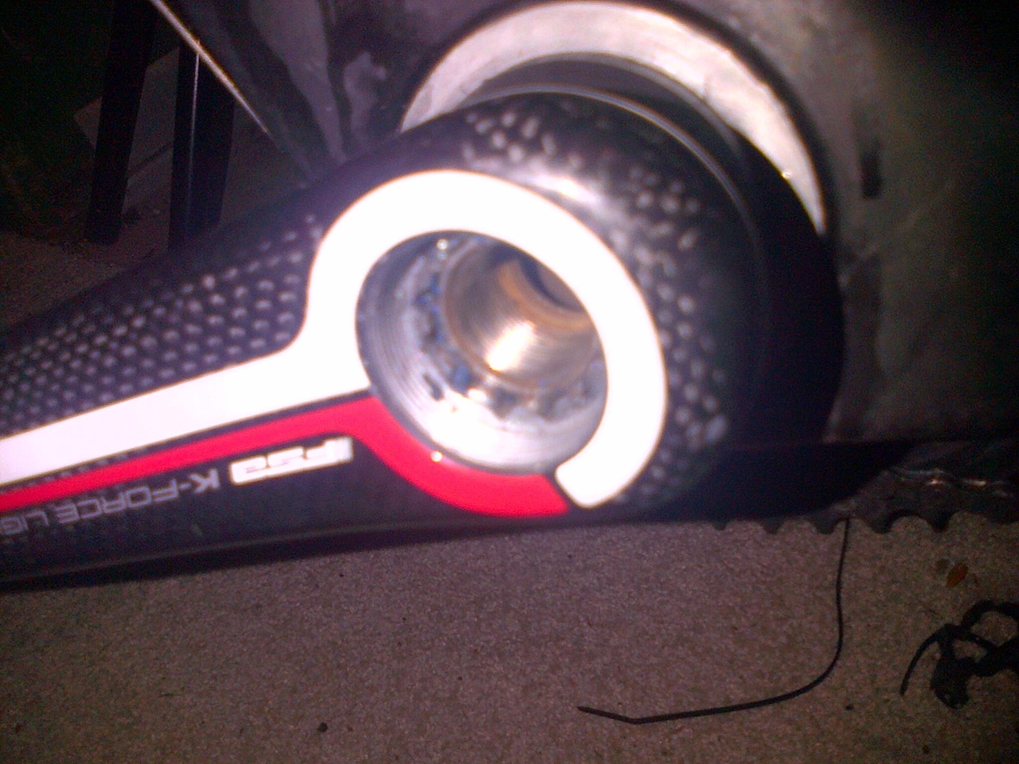

Hey guys,
After hearing creaks and clicking in my bike I got home and begun to go around checking everything over and I found this. This arm is only around 3months old too!
Less than ideal, but is it still rideable? At least for the mean time whilst a replacement is found? All thats missing is the self extracting bolt assembly so it is being held on by friction. Similar to a 3 piece crank arm.
And any ideas about how to remove this?
Cheers,

That is not safe to ride. Without any pinch bolts, friction is not enough to keep the arm secure. Once you obtain the self extracting bolt assembly, you can just install the assembly and then remove the arm. Kind of a catch 22 situation.

Darcy, there isn't any tearing of the metal or delamination of the carbon or seperation of the carbon from the aluminium is there? (hard to tell from the picture).....if there isn't......I can send you a bolt and extractor cap (I never use them anyway....I use an old-school crank puller) to tide you over until a matching one arrives. It's Geoff. Ring/txt me 021 2162328....get a bolt in it NOW.....and I'll send you a "semi matching one" while your replacement arrives.

Found a bolt from one of the other K-Force cranks I have been through. So this will hold it on. Just need to get another self extracting bolt set up and loctite it in and hopefully get my crank off.
What loctite would be best suited to holding the self extracting bolt in?
@Theremery The cranks fine from the looks of it. I need to get a new self extracting bolt set up so I'll just put one on order and I've got bolt in it now so I'll be sweet till then.

That bolt, when adequately torqued, should render the bike safe to ride. I use Permatex threadlocker blue #24240 in this type of application. Your best bet is to stick with the blue threadlockers; do not use red.

yep....just a low strength loctite will be fine. Red is overkill and may lead to dramas if you later decide to pull the crank using a standard extractor.
