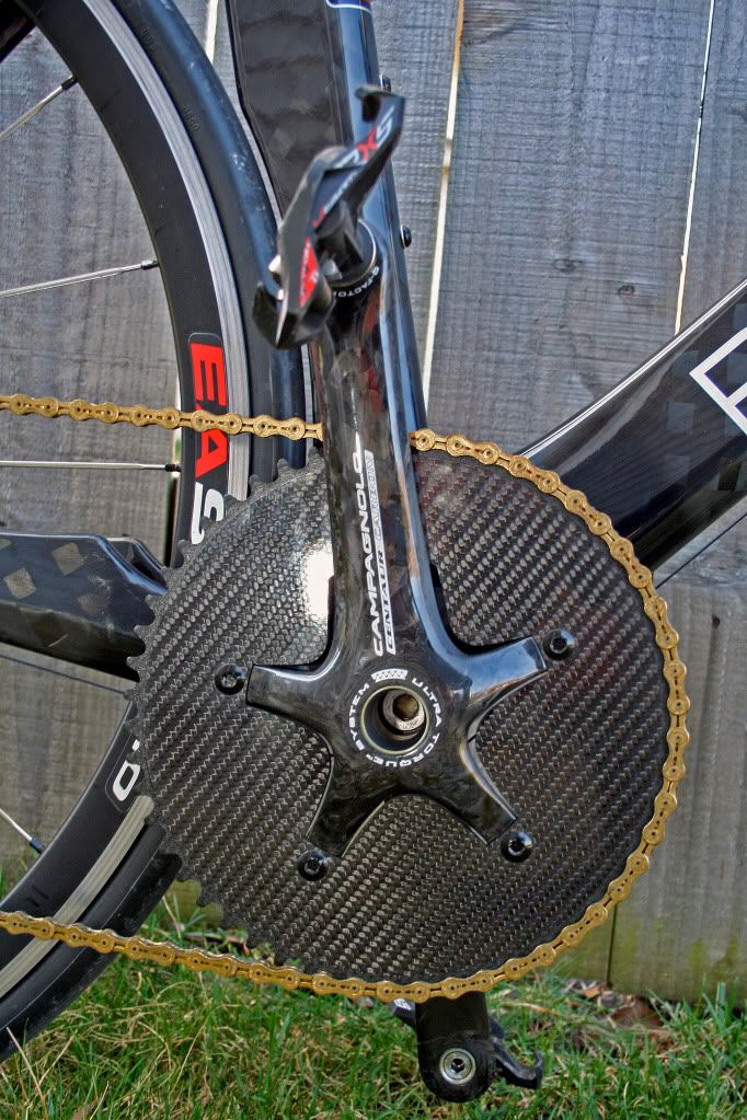

While I sit here and wait - since october - for my new Canyon CF Speedmax Evo, I have started preparing some of the things I am going to change on it.
The Shimano Ultegra crankset is first thing up - need to replace that with something lighter, and more bling.
For the project, I have bought a Sram Red 2011 GXP crankset (BCD 130) with Sram (53T) og Shimano (42T) chainrings.
After some sanding I have added this stuff:
- Black Sram Powerglide 39T chainring
- Black TI chainring bolts
The scale is out of batteries, so an updated weight will have to wait.
And then I just need my new Fibre-Lyte "total aero" 54T chainring - it should fit like a glove. Similar style as the one Tillquist used with his old Dura Ace 7800 crankset.

Kind of:
Like my old tt bike. :beerchug:
Author:  Juggler [ Thu Feb 07, 2013 3:07 pm ]
Post subject:  Re: New aero crankset for my Speedmax Evo
Exactly... :)
Where you satisfied with it? And will you confirm, that your chainring is 2 x 2 weave...
Author:  Juanmoretime [ Thu Feb 07, 2013 4:15 pm ]
I ran single ring and it was a 2X weave. The ring was very stiff and with zero fact behind it the carbon to steel chain seemed like less friction. Also carbon on metal chain runs very quiet. I ran mine for two seasons, approximately 3,000 miles, with no perceptible wear.

One last thing... what is (was?) the weight on that 54T aero ring of yours?
Author:  CarpetFibre [ Thu Feb 07, 2013 7:49 pm ]
I had one too just like Juanmoretime fitted to an FSA SLk crankset. Mine was 48T and it was absolutely perfect. Can't recommend Fibre-lyte enough! I just ran a single at the front so I had the larger tooth profile. It worked a treat and I never had a chain off and I didn't even run a derailleur or chain guide at the front.

Author:  Juggler [ Thu Feb 28, 2013 3:44 pm ]
The total aero chainring from Fibre-Lyte arrived today - thanks, Stephen... it looks (and feels) awesome.
The final result: 659 grams of aero crankset with 54/39 tooth chainrings and TI-bolts.
