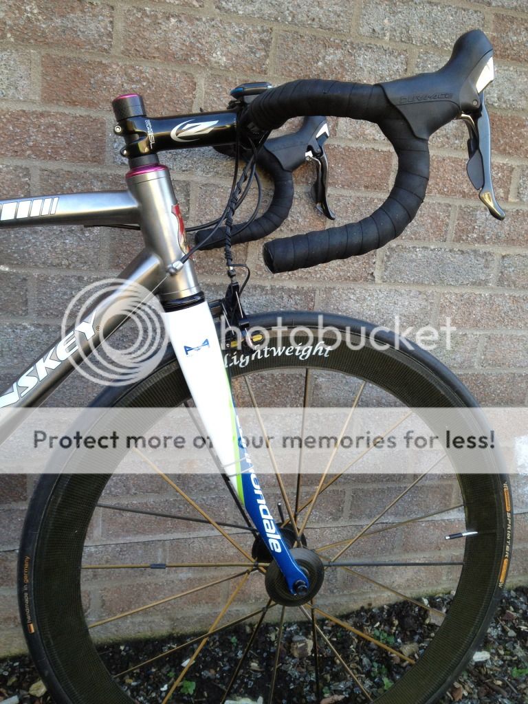

PostPosted: Mon Dec 10, 2012 5:50 pm
Formerly known as CAADHEAD
Posts: 1358
Location: WALES,UK
Well I had to try it! Lyndale or Cannonskey?
Ti or dye!
PostPosted: Mon Dec 10, 2012 7:19 pm
Joined: Wed Oct 18, 2006 10:15 am
Posts: 183
and... how does it ride?
do you feel anything different?
PostPosted: Mon Dec 10, 2012 7:45 pm
Posts: 1358
Location: WALES,UK
Well I rode it around my shop car park, didn't feel especially different but I need to give it a proper ride. I estimate it lifted the front end 8mm, the stack height of the cane Creek 110 minus the stack height of the Chris King internal. Also the Enve forks that were on there were 43mm rake as opposed to the Cannondale ones which are 45mm I believe? I picked up the forks for peanuts and it was dead in the shop today so I thought what the heck! I thought I'd have to adjust the saddle angle but it seems to have hardly changed even though the front has gone up. So I know what the headset has added but not sure what the rake change combined with that has done? I believe the axle to crown of the two forks is almost identical?
Ti or dye!
PostPosted: Tue Dec 11, 2012 6:10 am
Posts: 175
