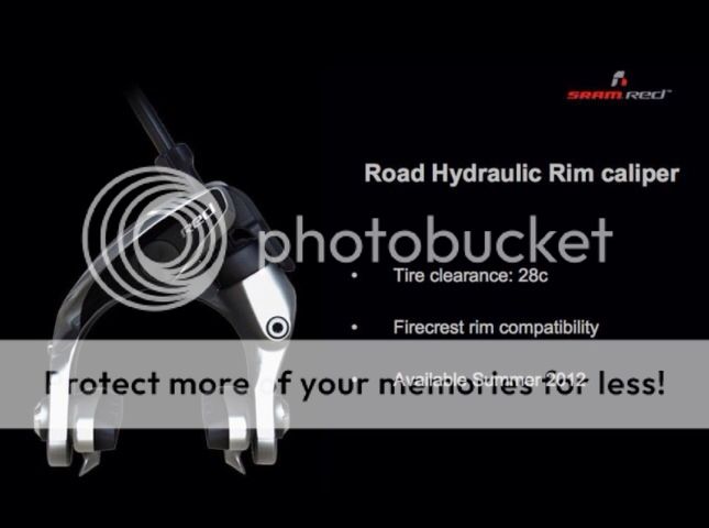

I'm sure it will work great, because no one ever has a problem with Avid hydraulic brakes

I'm getting your sarcasm, but some can take this sentence as a trueBoSoxYacht wrote: because no one ever has a problem with Avid hydraulic brakes
